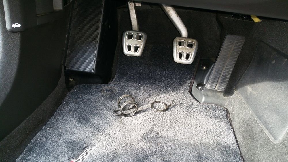

Without putting my foot on your clutch I cannot tell you if it is stiffer than stock. You might check the spring underneath the clutch pedal and see if it is present or broken, it is there to make the pedal easier to push. I have however driven Minis before and their clutch pedals are far lighter than a C5 with a stock clutch and pedal assembly.

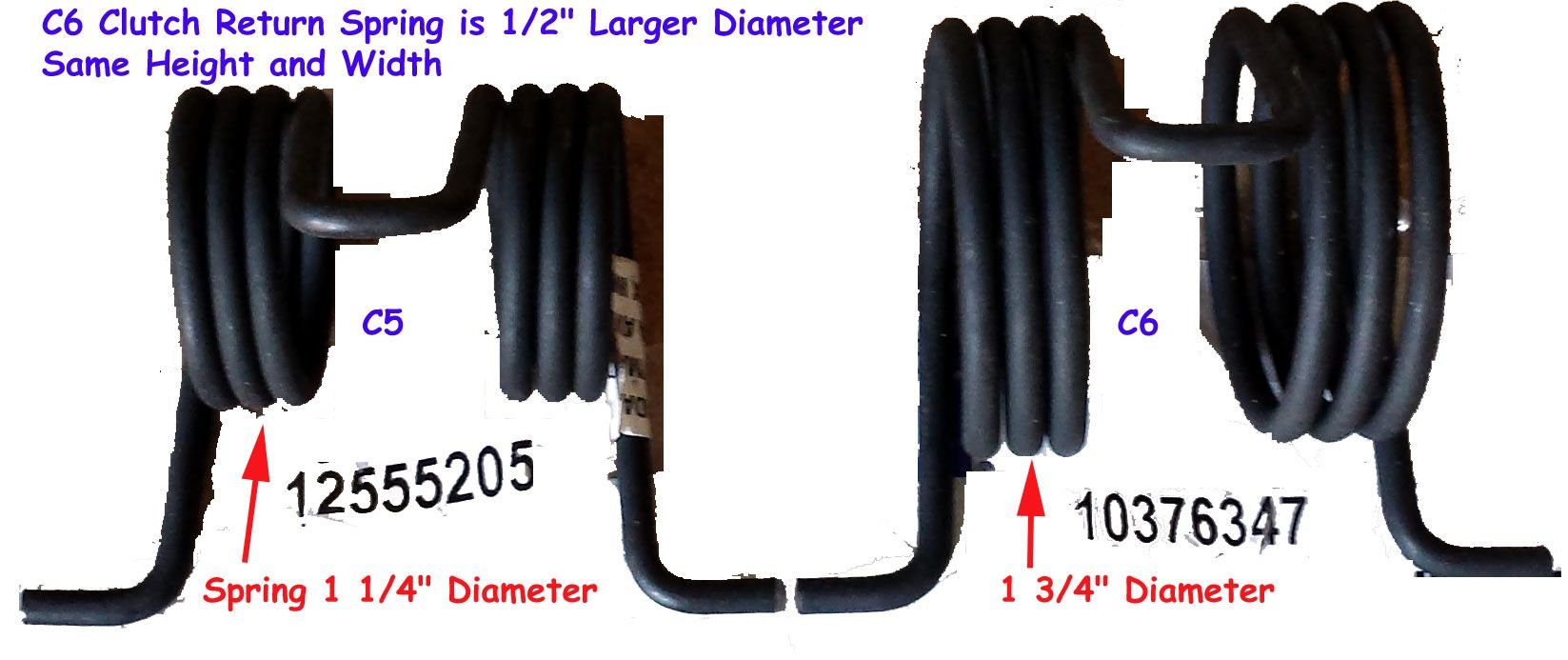

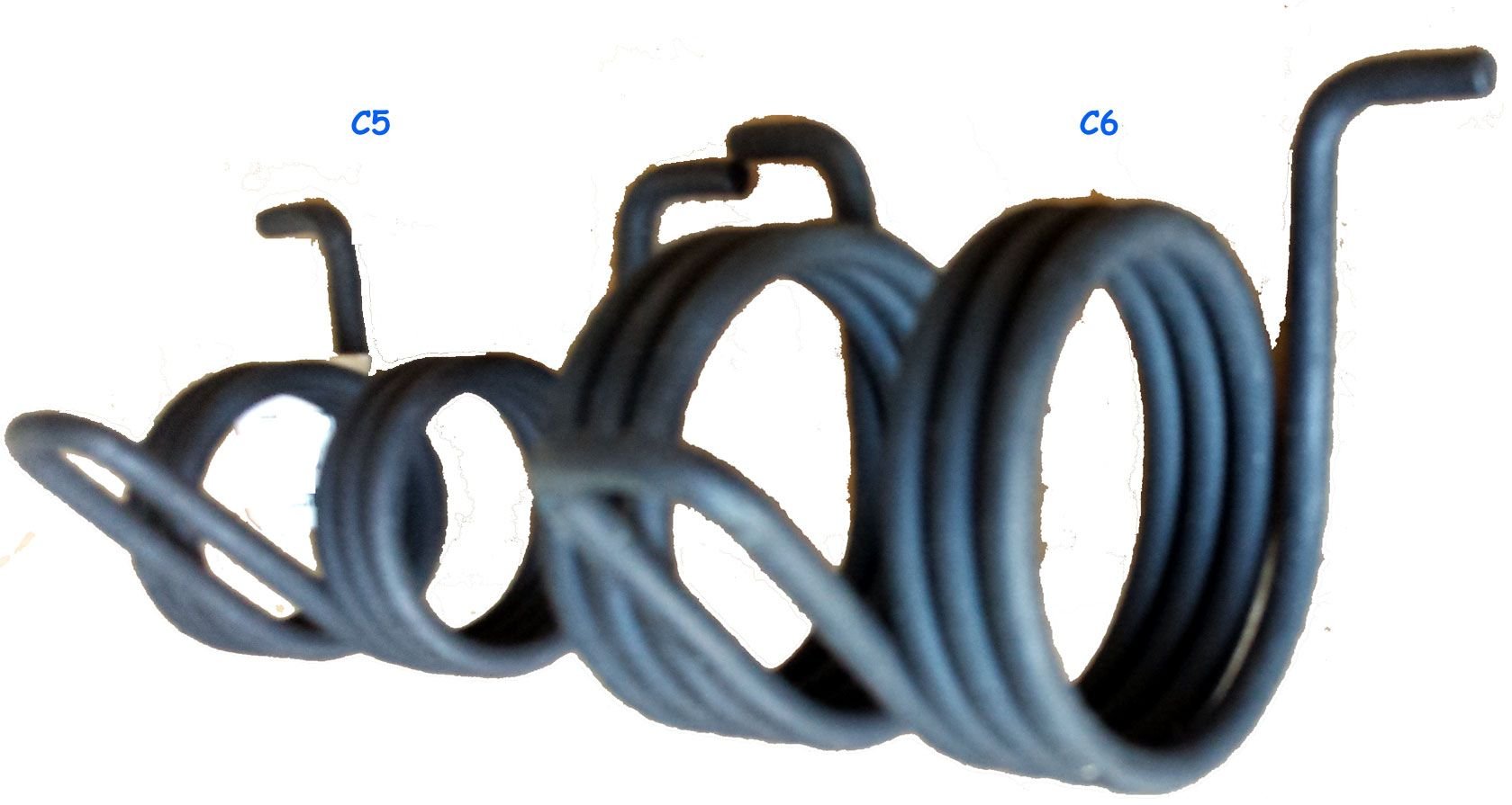

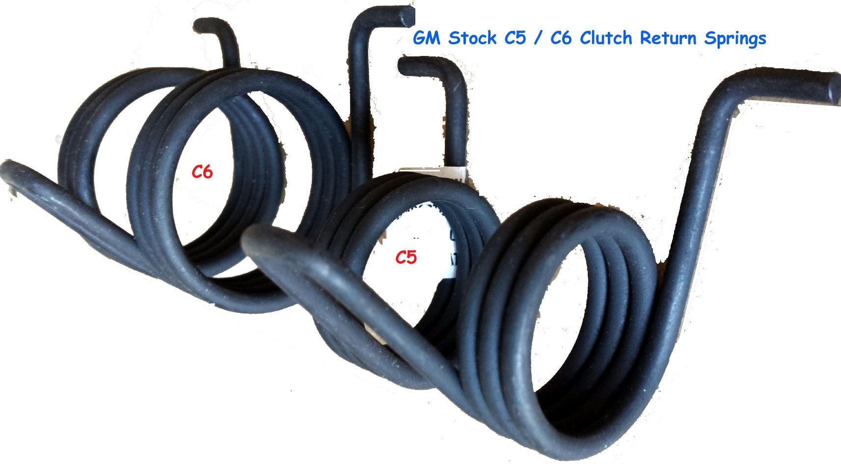

I agree it could be the clutch pedal spring that has broken.
If you want an even lighter feel, you could get the bigger C6 spring.
I can't confirm if this is a 1-1 swap though
