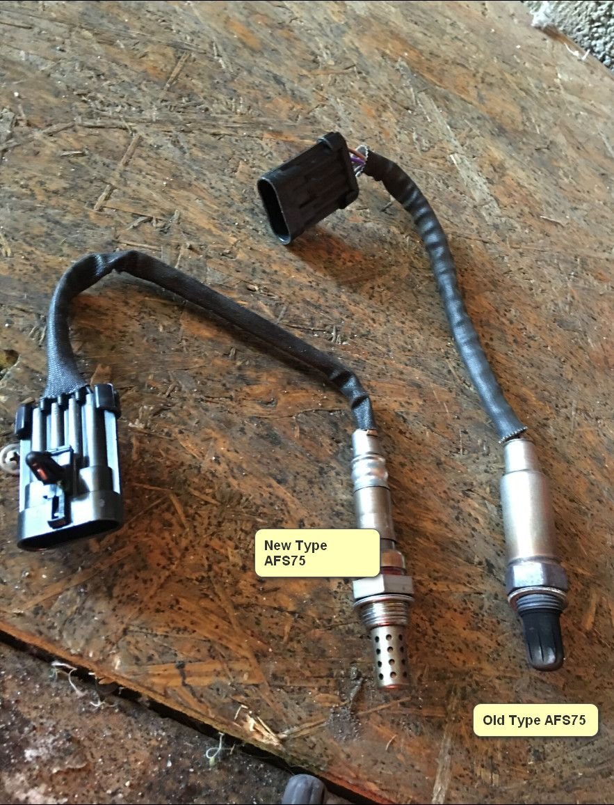

I use ACDELCO AFS75 (new type with flat head)

[QUOTE=oelarse;1605196796]I use ACDELCO AFS75 (new type with flat head)
That’s perfect thanks, i’ll get them ordered
