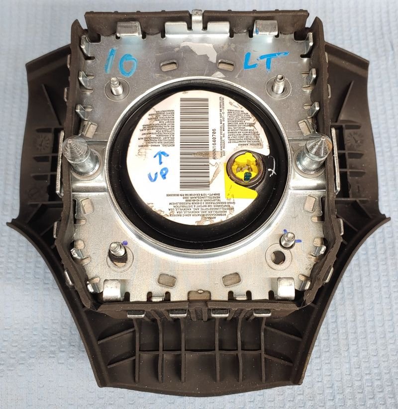

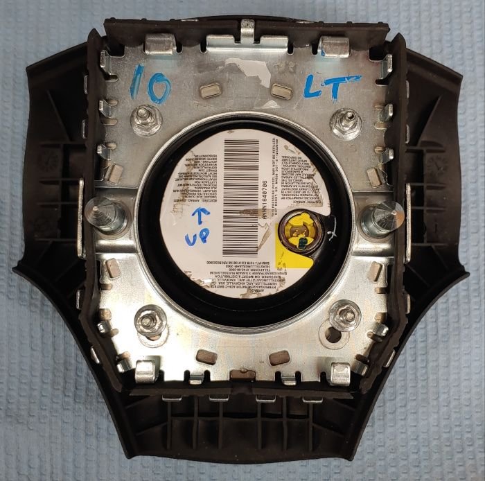

Here's all the parts together:
I started working on fitting the single stage airbag into the Cobalt airbag cover. Others have mentioned it being a tight fit and some modifications required, and there's certainly no doubts there:
  • 2 of the Cobalt/C6 mounting bracket holes have to be re-drilled (will take a pic)
  • Single stage airbag mods:
    • metal bracket needs to be trimmed (red lines below)
    • 2 tabs (vertical arrows) need to be removed [tentatively]
    • 2 tabs (horizontal arrows) need to be pounded flat [tentatively]
  • Single stage airbag is bigger than Cobalt/C6: taller, wider, and thicker. The height & width seem like they will work out okay. The thickness is what ultimately concerns me, and we shall see.
Because I bought a whole column, I also have the mating clock spring harness. Should make wiring in the clock spring more reasonable.
You can also see that I have an airbag connector pigtail, which was a nice addition from purchasing the single stage airbag.

Originally Posted by link9a
great. So this airbag need some work to make fit with cobalt cover ? Do you have the part number for clock spring ? And do we need the clock spring harness to buy or no ?
The single stage airbag I bought has an embossed P/N 16866042 on the cover, and this brings up some options on ebay.
This clock spring is a 2008+ which has P/N 26129609. You don't need the harness for it, you can just cut off the connector that normally plugs into the harness, and run your wires out. It's just easier for me to run the harness because I bought a whole steering column.
I think clock spring P/N 19153097 can also work.
Yes it definitely needs some work to make fit. BUT tonight I got the single stage airbag situated into the cover! Its thickness made it an especially tight fit but should be okay. Here are some pics:
1) Everything trimmed/modified per my last post, and with 2 new drilled holes in the Cobalt/C6 backing/mounting plate:
2) Nuts added (used the nuts that came with the Cobalt airbag):
3) And another angle:
