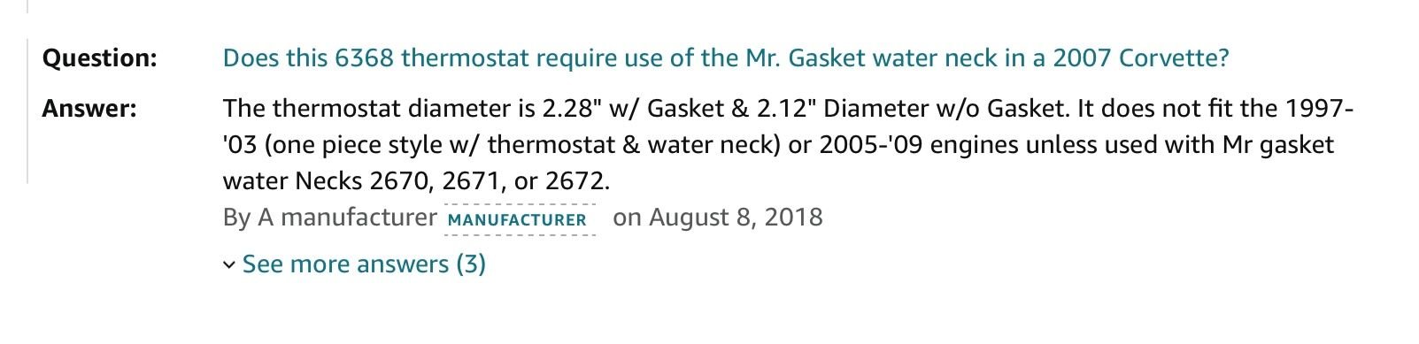

I have a custom tune. Way past that stage. I'm trying to find a stat that is the same physical size as my 160°, but in a 174° or 180° rating. Sorry if I wasn't clear. I'm trying to raise my minimum temps, slightly. My old, correct sized stat measures around 2.280" with the seal in place. The 174° is around 2.370" w/seal, and the supposed 180°, which is stamped 203°(!) is around 2.580" w/seal, plus its about 3/8" shorter than the correct 160° stat. There is no way the LPE 174° will work, and neither will the 203°, which I wouldn't run if it DID fit! A 203° stat is way too hot. Thank you for responding, but the physical size is my biggest problem, that and I think the the L310055204 box, which is supposed to contain a 180° stat, had a 203° stat. Anyone know if that L310055204 is supposed to be a 180° stat? That's what I'm finding online, so far. Maybe just the incorrect part in the correct box? Sheesh, what a vegetable soup of stats!!!

I bought the Mr Gasket 180° for my 2004, but have not installed yet…. In any case, this stat appears to be the same size as your old one.
