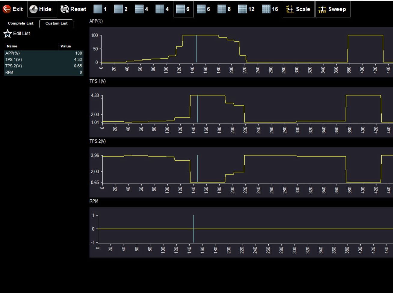

I did a check of the thottle by pressing the pedal to to the floor and the TPS 1 and TPS 2 signal seems to move correctly ( no error codes from the TAC module/TPS system

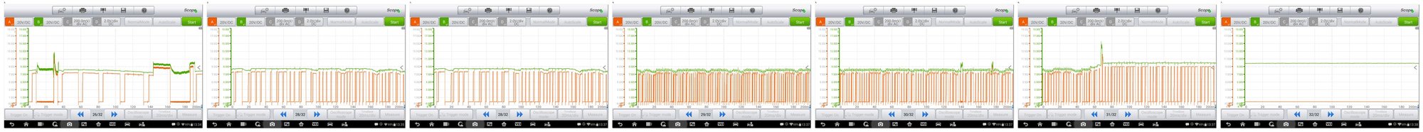

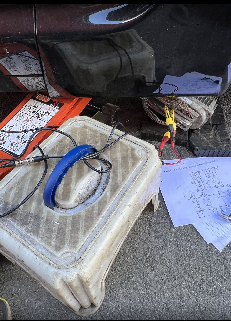

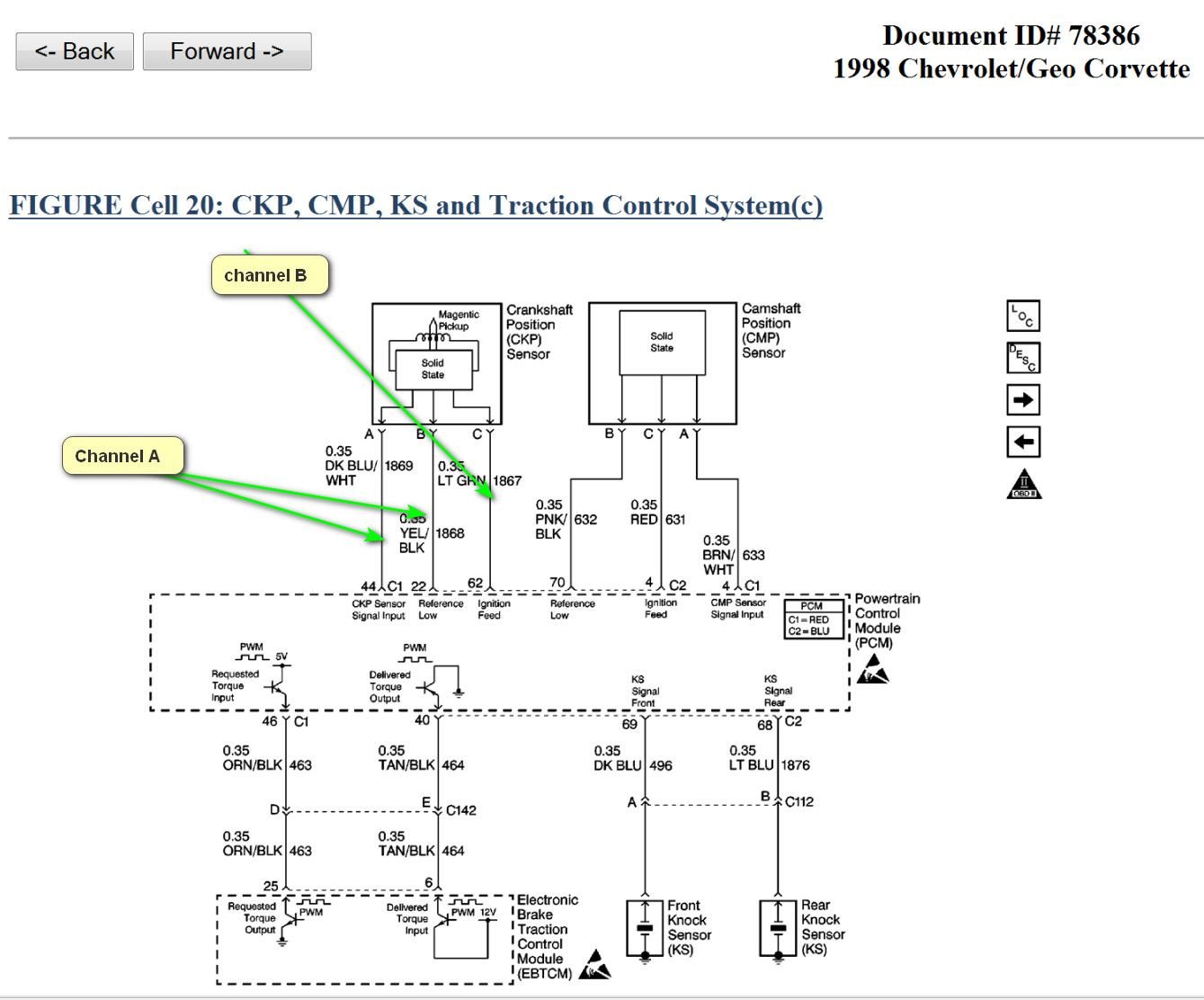

It was a sunny day outsidemy house n my part of Norway today and I was able to scope the Crank sensor signal with my scope wih piercing probes
This is a Hall effect sensor as far as i Know
I tried to put together alle scvreenshots from my scanner into one looong picture and hopefully is understandble , if no I
with my phone also .
After cranking some seconds it seems to fire on some few cylinders some more seconds before the engine died . The signal from the crank sensor seems very unstable and
This kind of change in signal amplitude and signal outlook indicates to me a "sick "crank sensor that needs to be replaced , agree ?
Finally I put some liquid tape on the piercing points of the three wires

Yes, it is a 3 wire Hall Effect Sensor…the signal at one point looked around 7 volts and that’s not enough for the PCM to process correctly.

I played around with my own car a couple of years ago and I see my crank signal is switching 0 to 5 volts while my camshaft sensor switch between 0 and 12 volt
Both should be 0-12 volts !!
