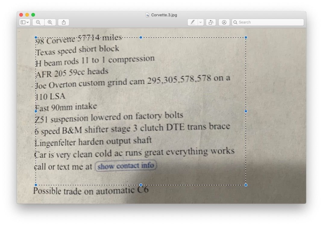

I am thinking of removing my CATS on my 98 C5. Along with long tube headers, here are my mods; Kentucky does not conduct emissions testing. I also have a CAI. Any thoughts?

Can't go wrong with AFR heads. Good choice with 205s. One bit of advice; if you're capable of doing it yourself, measure the installed height on the valvesprings. You'll need a special micrometer, and a valvespring compressor. Call AFR for the installed height spec. It's probably 1.780", or 1.800". I once bought an early set of their 225s. Installed height was off by .100"!!!! Found after I broke a spring at only about 300 miles!!!! Best of luck to you.......
