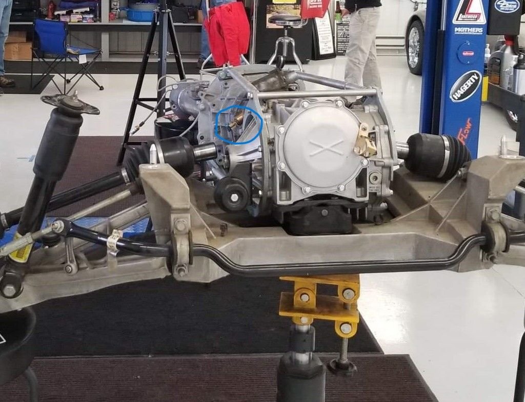

here's my skip shift eliminator circled in blue the wiring harness isn't connected when you use one of these. It's just a resistor that's soldered in to soleniod plug

it come as a kit to plug off the solenoid and the harness connector to keep water out. I just zip tied the harness side to the fuel line. You dont need to tune it out but you will still see the skip 1-4 light come on but it wont lock you our of gear.
