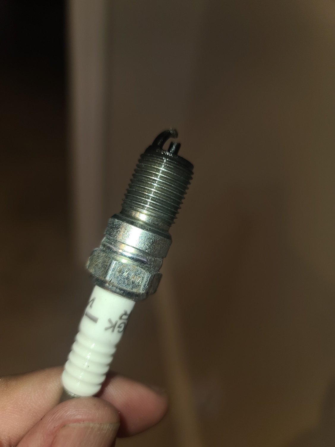

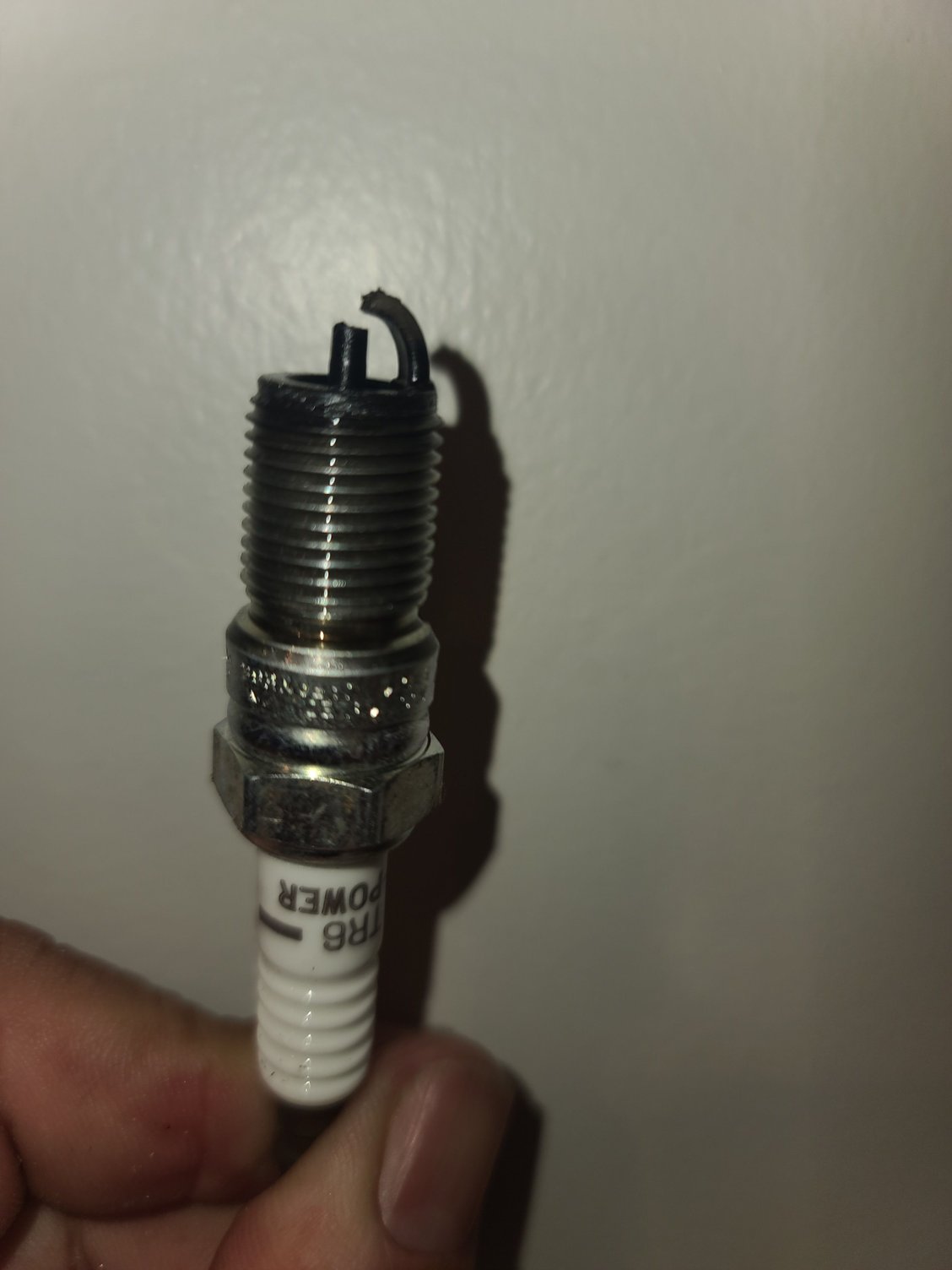

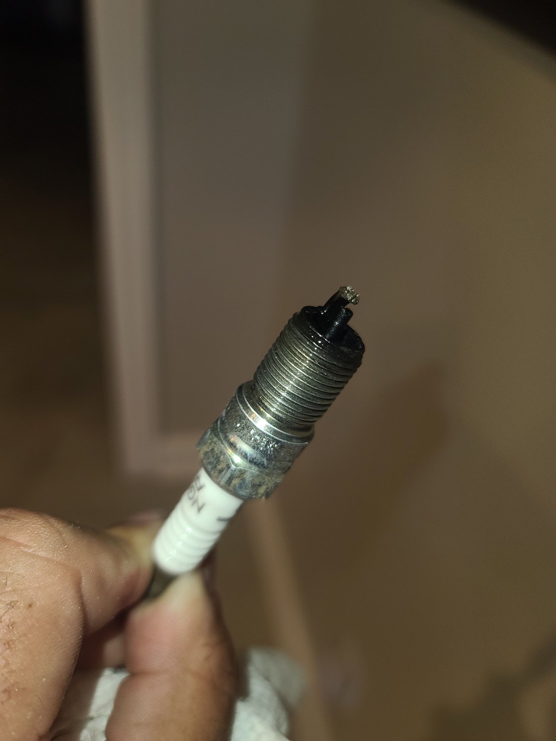

Well here's #7

That plug looks fouled to me. Change your plugs and see what happens.

Plug looks wet. I would start off with new plug and swap wires with another cylinder. If problem does not move then swap coils with another cylinder. Hopefully one of those will be the problem.

I'm seeing a broken tip...whoever did the last plug re-gap, broke the tip or a factory defect?

yeh, I think you are right. Didn’t spot that. New plug.
