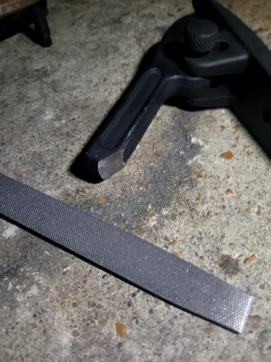

I am in the process of replacing my wheel hubs. Trying to separate the spindle from the lower control arm but the ball joint separator tool won't open wide enough to get into position. What is the best way to proceed?

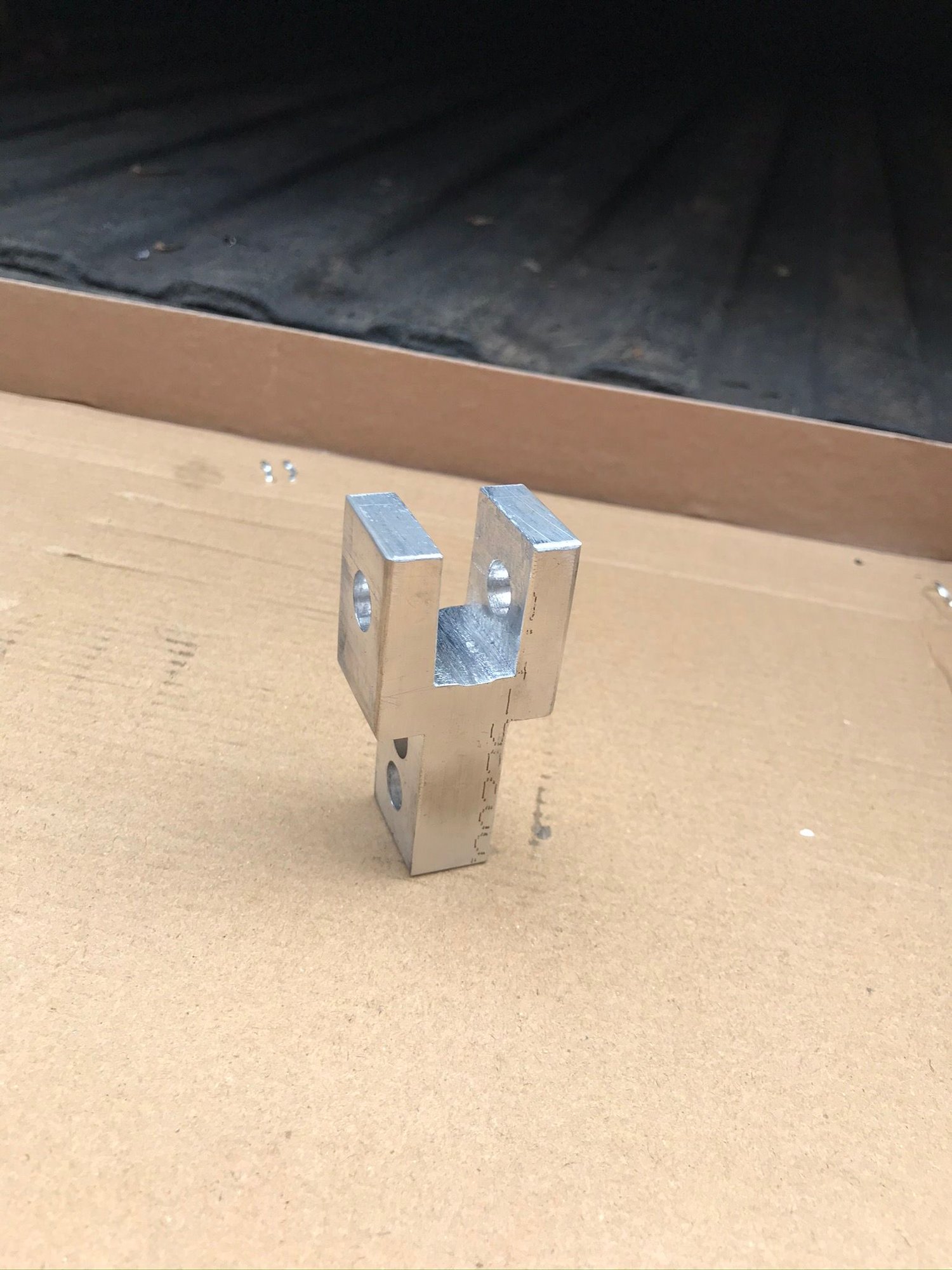

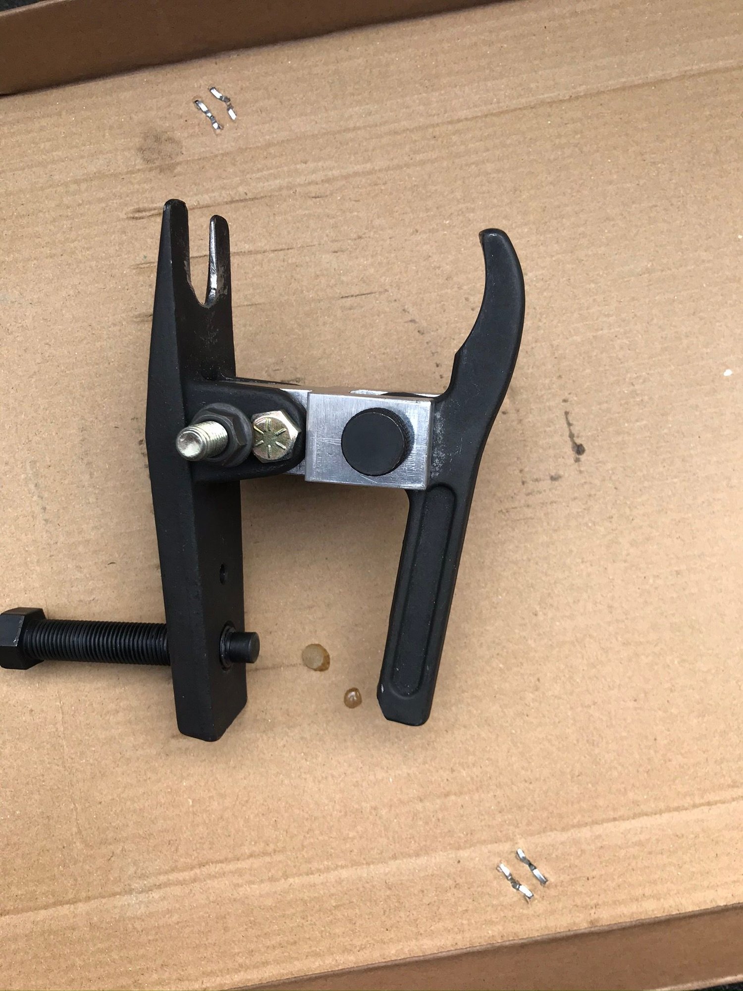

I did what Smitty suggested. Grind the corner of the arm at the end near the puller bolt. That will let you get a little more angle.
I also made an extension for the puller. You may be able to come up with something easier to make that would work (maybe just two plates with holes for the pins.

Not a bad idea at all. I don't have a workshop or anything with that kind of tool but maybe I could use a file...

Okay that's awesome. Show off!! 😆

I should have taken your advice, just dont have much if a budget for one more tool right now... the file worked. Only took me about 2/3 hours 😆

Job is done and I really appreciate everyone's input. Ultimately I filed down the ball joint separator (after several hours) and was able to open it enough to do the job. I knew there were other options but I really didn't want to risk damaging the boot and having to replace the ball joints. Its a long story, that I will eventually share on C5 general, but I've sunk thousands more into this car than I ever intended to thus far. Planned on giving this car a paint correction and selling it before my first payment but I was hit by a hit and run driver. Since I didn't want to have my rates go up again after my last accident I am doing my best to learn how to become a shade tree mechanic and fix this ol' girl myself.
