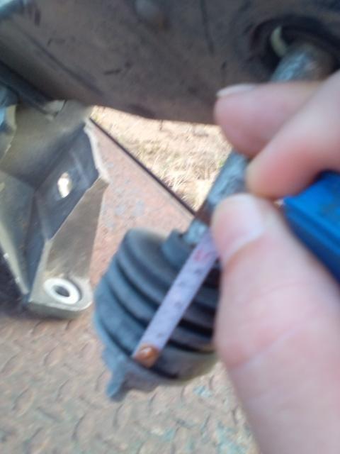

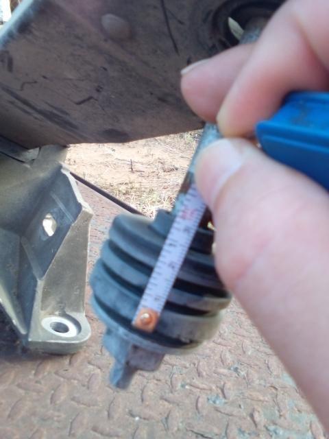

Man im comfortable with the loctite i used it last year on some home depot bolts the same size but removed them after hearing the stock bolts were stronger. I think they maybe longer bolts then stock not sure dont want a home depot bolt to snap and drop the wheel up into wheel well.
I used red loctite on the top thread and when i went to change the stock bolts back man were the nuts tight i left too much red loctite on the top threads had to use brakleen to try and remove the home depot bolt nut set. yes i think blue or green loctite will work.
Now are the prothane or energy suspension bushings shorter then the factory bushing which are 1"? the prothane or energy suspension look about 1/2"-5/8" which would allow more room to lower the vehicle with shorter bushings. I emailed energy suspension with photos if they had height dimensions.
Has anyone seen one of these prothane or energy suspension bushings in person and know if they are indeed shorter then the stock 1" bushings? Would allow for more lowering. The prothane or energy suspension look like theyre missing the third layer in terms of height and solid real durable. Great thanks for the help.

I spoke with prothane tech line 71025 is .700" and stock rubber is just under 1" so it would maybe add extra 3/8" lowering once both top and botton bushings are changed. Now i wonder if the energy suspension bushings are the same .700" as they have lifetime warranty if the bushing were to ever crack.

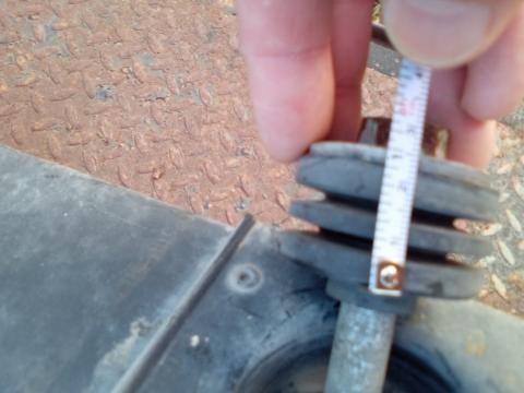

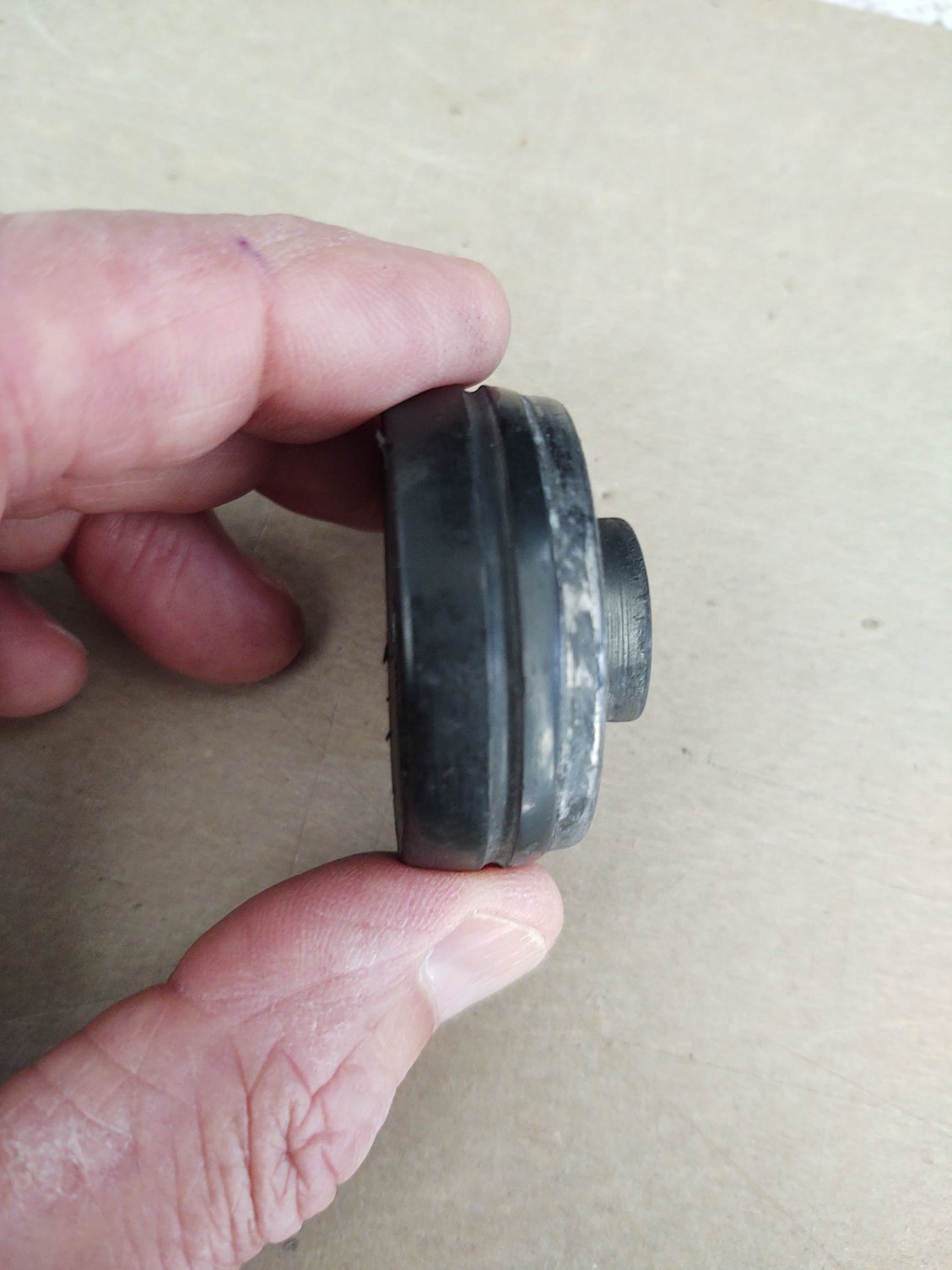

Is this the kind of bushings that your car has? Below, is a picture of one of the bushings that my car has four of, and the ones I just replaced. My Energy Suspension replacement bushings look exactly the same.
The body of the bushings is 11/16" thick, and including the "stem" it's 1" overall.
Its 1" wide or 1" tall with the stem that tucks up into the spring or a arm recessed area? Thats perfect allows more room for lowering.
1" tall..........
Can't help you with the dimensions of the ES bushings, as they're already in the car, but just in looking at them, they're pretty much the same as the OE pieces. Just my $0.02 worth, you're putting too much emphasis on the bushings, as a determinator of ride height. It's the tension that's put on the spring ends, via the bolts, that's the final factor that determines ride height. And one other "tip", the factory point of measurement, for ride height, is the center of the bolts that attach the arms to the subframe.....
Now 11/16 is .6875". Prothane told me .700 im not sure i didnt here from energy suspension would prefer theres because of the lifetime warranty never know they could tear or break in half. Im not sure if the stock 3 piece layered ones do collapse with tension hard to say. Not sure which way to go with prothane or the energy suspension. Theyre nice bushings i like them because my rear sway bar end links are already red maybe energy suspension or look to be replaced and someone got rid of the f45 shocks and put stock base model shocks. Last year when i was raising the ride height i noticed one was in bad shape and wondered where i could find new ones but i think polyurethane is best. When i get that far im going to lower it one 1" or try to even it with the front. Yours compared to mine the prothane or energy suspension black one is .6875" 11/16 fraction prothane repsonded to my call and informed me they were .700" tall which is good as the stock ones are over .900". The prothane ones are 16$ on ebay with free shipping or from energy suspensions website the energy suspension are 17 plu 9 shipping around 26$ directly from website. They are good tho if you get the warrantied ones. I used polyurthane think it was the energy suspension 55$ kit on all 4 control arms upper and lower 8 bushings on my 95 z28 in 2008-2009. Didn't make the ride stiffer but are nice products. Had to let the old rubber burn out with a butane or small propane torch. Theyre good stuff.
It'll probably be a few months till i purchase them but i bet either one would work maybe prothane is best if one tears your out 8$. Im not sure if the stock rubber 3 slits ones collapse with weight but i somewhat doubt it i would think they're solid and stay the same height. Another thing was the ebay sikspeed lowering kit for 26$ curious if theyre a name brand prothane, energy suspension lol 2-3$ bolts you can pick up at home depot except home depots are fully threaded. When i asked them about the length by ebay message they didnt say much just 8 pieces to lower the corvette 1" which can be done on factory equipment.
Leadfoot4 these are energy suspension or prothane? Thought you said you couldn't measure as they're in the car but is that your hand holding one of the bushings or is that an internet picture of the bushings? How did you figure out they were 11/16" .6875" or prothane .700 bushings? Deciding which ones to purchase yes id prefer the ones that arent as tall as the stock .900 bushings.
Those are the 21 year old, OE bushings that I took out of the car, a couple of months ago..... And to address your question about changing the front adjusting bolts, I'm pretty sure you'd have to remove the spring from the car. In other words, a major project.

Those black ones in your hand are oe bushings? The ones in that cradle are stock 2002 bushings and same as my 99 bushings.

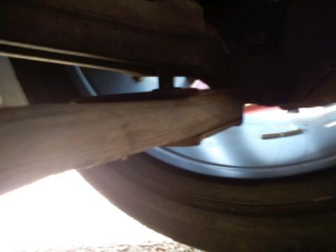

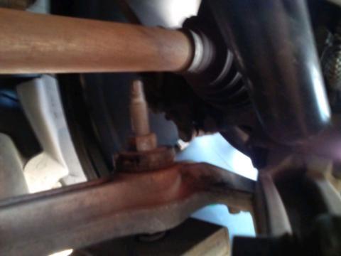

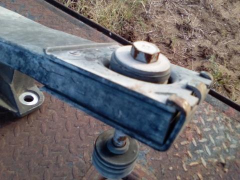

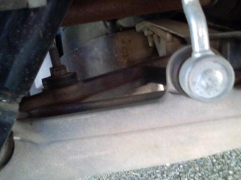

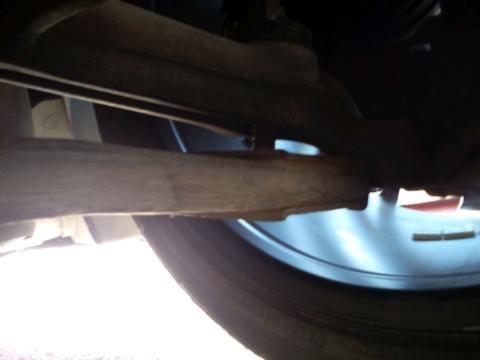

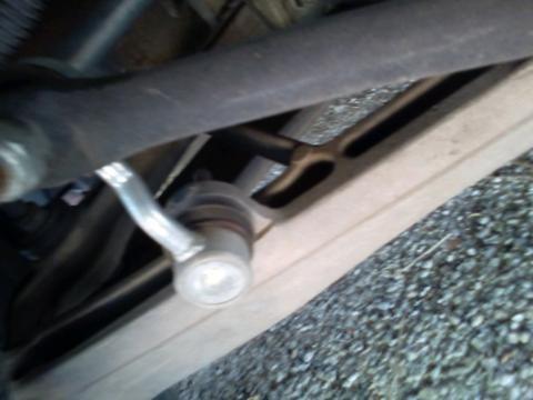

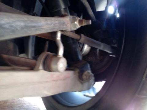

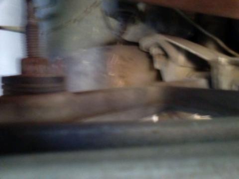

Yeah you bet with weight on the stock bushings the 3 inner lines collapse so i would get some solid energy suspension or prothane. My leaf spring is 3/8"-1/2" at the farthest end from the control arms on both side maybe 1.25" of threads so to get prothane bushings you can see ones is kind of falling apart and lower it atleast 1". Nothing is binding. Just as high as itll go nearly.
These are simply just new sway bar end links i think. I raised it as high as i could without binding The fronts have about 3/8" of thread above the leaf transverse spring and 3 finger gap at most and the rear has a good 1" it could be dropped to even it with the front. You can see the one bushing has a chunk out of it why i was looking for replacement bushings i may go with prothane 8" or energy suspension either way theyll need replaced eventually.

Not quite sure where your spring sits, in relation to the lower a-arm, as your pictures aren't all that clear. However, it appears to me that your spring does come closer to the subframe than mine. In the picture below, you can see my spring just peeking out from under the a-arm. This is with the car sitting on the ground, at ride height.
