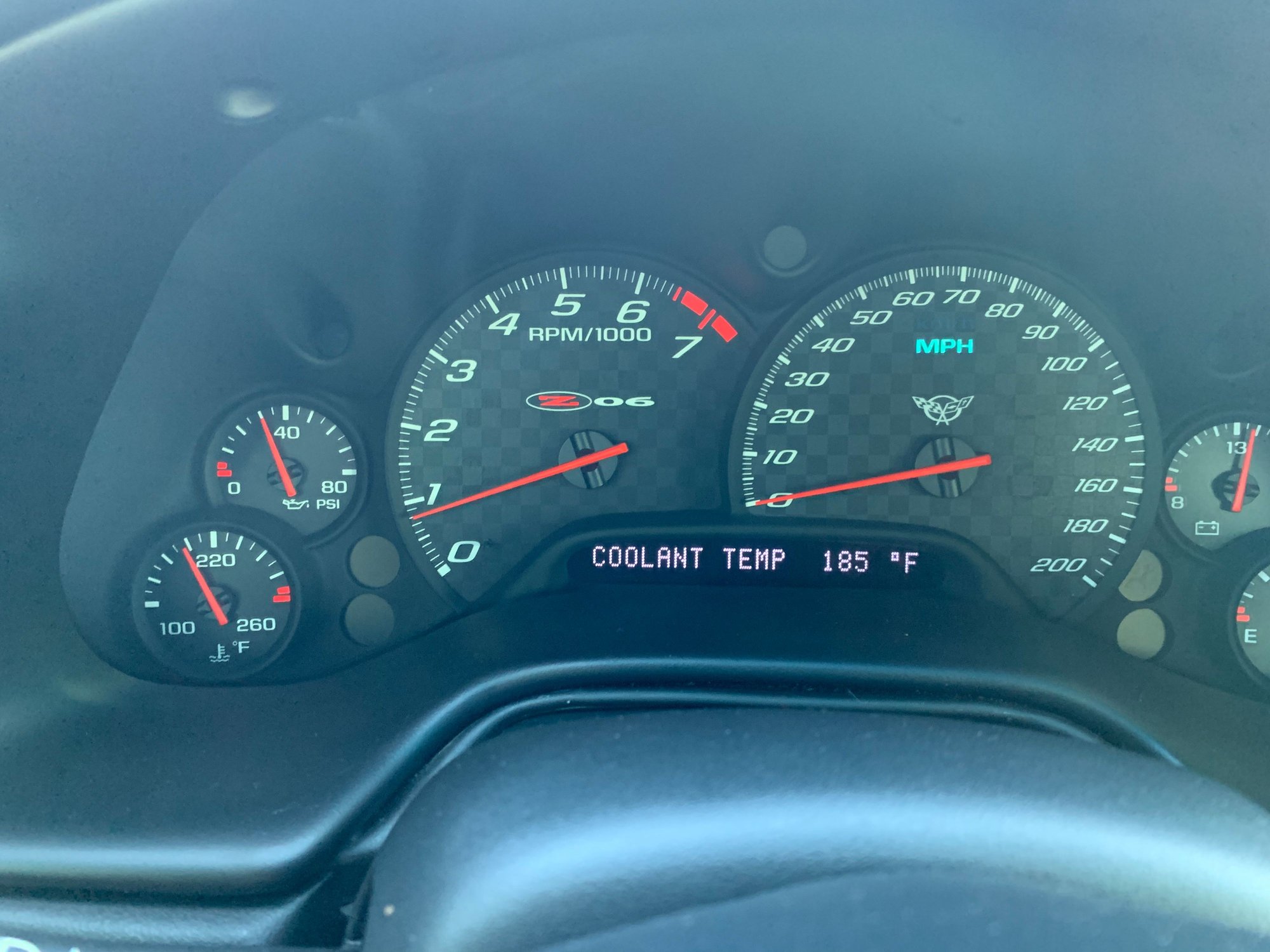

Upper 80s here today. This is on rt2 in Md in stop and go. I have never seen this car over 200.
