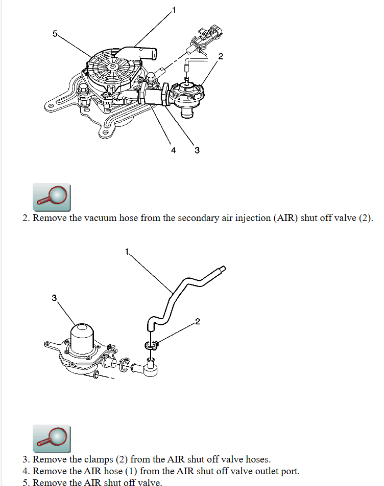

P0410 suggests that both banks are impacted. Common denominators for both banks are the PCM, AIR shut off valve, AIR pump, AIR valve solenoid, AIR pump relay, and associated tubing. Since you said the pump is running, that excludes the PCM output to the relay, AIR pump, and AIR pump relay. That leaves the PCM output to the AIR solenoid, AIR solenoid valve, AIR shut off valve, and associated tubing. The shut off valve is vacuum operated through the AIR solenoid when the pump is running.

Trying to save you unnecessary work here partner. That code is for both banks, not just one. If you had a single valve failure, you would have a P1415 or P1416. Great that the solenoid is working, and there is vacuum at the shut off valve, that does not mean the shut off valve is working, or the AIR tubing from the shut off valve to the connection is not leaking.

Very easy to test from underneath the car. Disconnect the large tube from the valve when the pump is running and you should feel air from the valve. If air is not flowing, check vacuum to the valve it self (small line in pic posted). If there is vacuum, and the valve does not open, the valve is bad. Last part number I had was 12558524.

Lucky,There is air coming out from tube when air pump runs at disconnected passenger side tube at Intake valve.So I will have mechanic check vacuum system off air pump location- ( from earlier picture location on pump) Thanks again- getting closer to resolution
