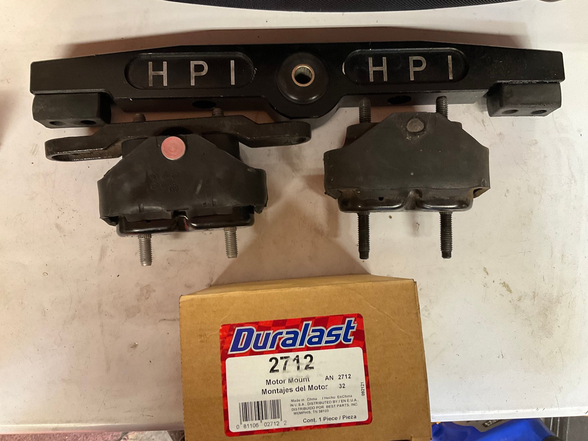

Ever since I changed my clutch, I have had constant rear end whine while at highway speeds in 5/6th gears. It was really loud and would quiet down just a hair when the car warmed up. However even while warm it was very obvious and annoying on my daily driver.

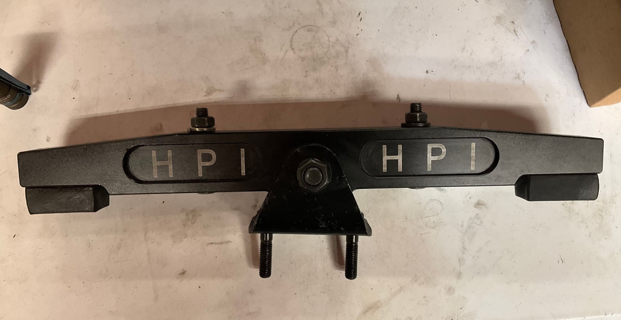

Some folks mentioned that there was something wrong with my diff because a whine is usually an indicator of internal issues. Other folks mentioned that they too had picked up a whine after changing their diff mount from factory to aftermarket. I had indeed changed my diff mount to an HPI design at the same time I swapped the clutch.

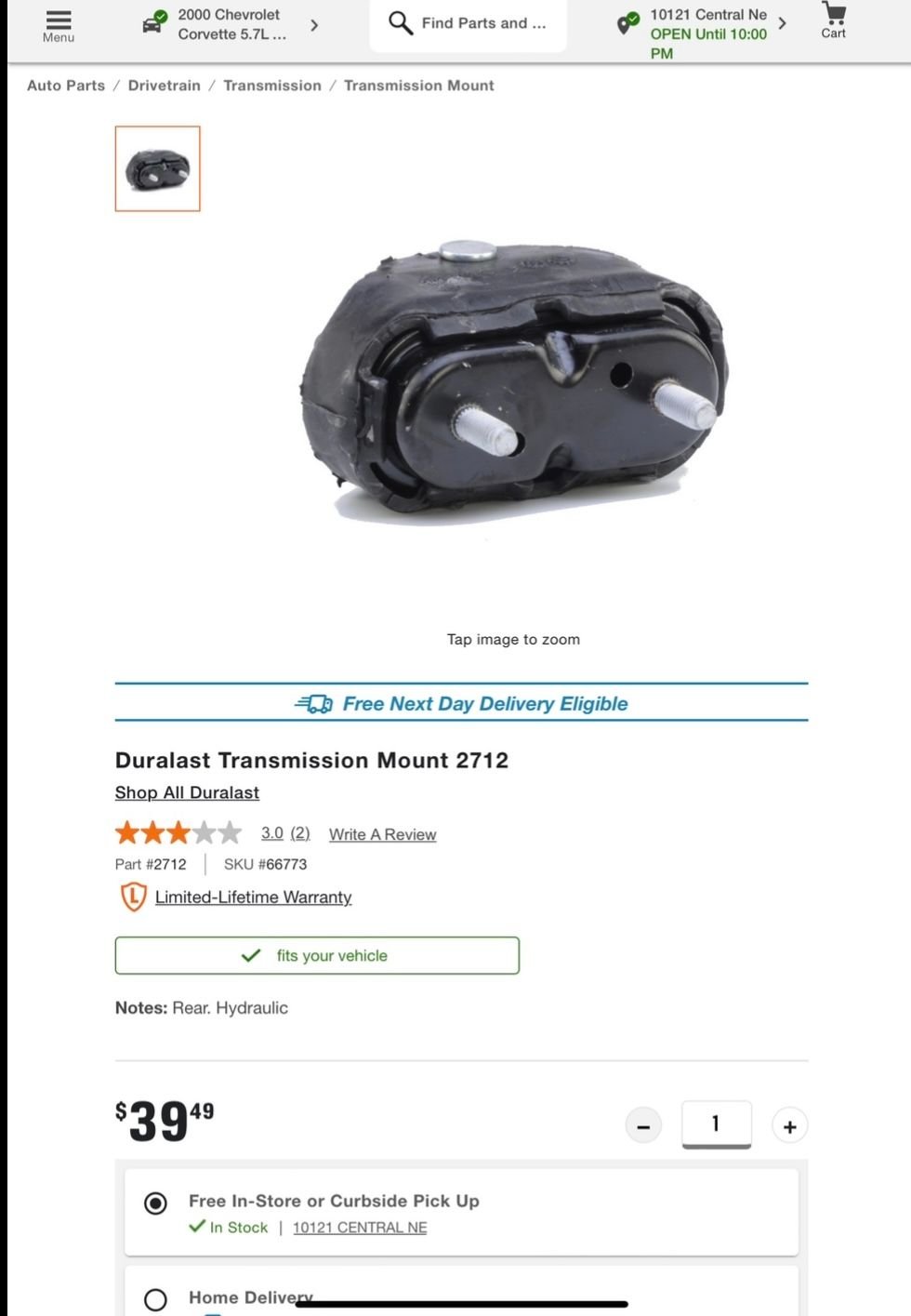

I wanted to go back to a rubber mount to see it that would be the source of the issue so tonight I picked up a new mount from my local AutoZone to give it a shot.
I am thrilled to report that going back to a rubber mount did indeed completely eliminate the diff whine I have had for about a year now
I figured that rather than putting in my 20+ year old crusty mount I would pick up a new fresh one. The new mount was cheap, immediately available and only took about 15 minutes to pick up locally instead of waiting on an Amazon delivery.
Here's the part number:
New mount on left:
The HPI mount would probably work much better for those folks who don't daily drive or otherwise wouldn't be bothered by the additional NVH this brings to the cabin
If anyone is looking for an HPI mount, hit me up for a good deal

While you guys may be correct, all I know is that my car had no whine whatsoever before going to the HPI, whined terribly after installing the HPI, and now has zero whine after returning to a stock rubber mount setup.
I have seen other recent posts stating that they picked up a whine after installing an HPI mount when before they had none. ¯\_(ツ)_/¯
Either way I am satisfied with my outcome.
