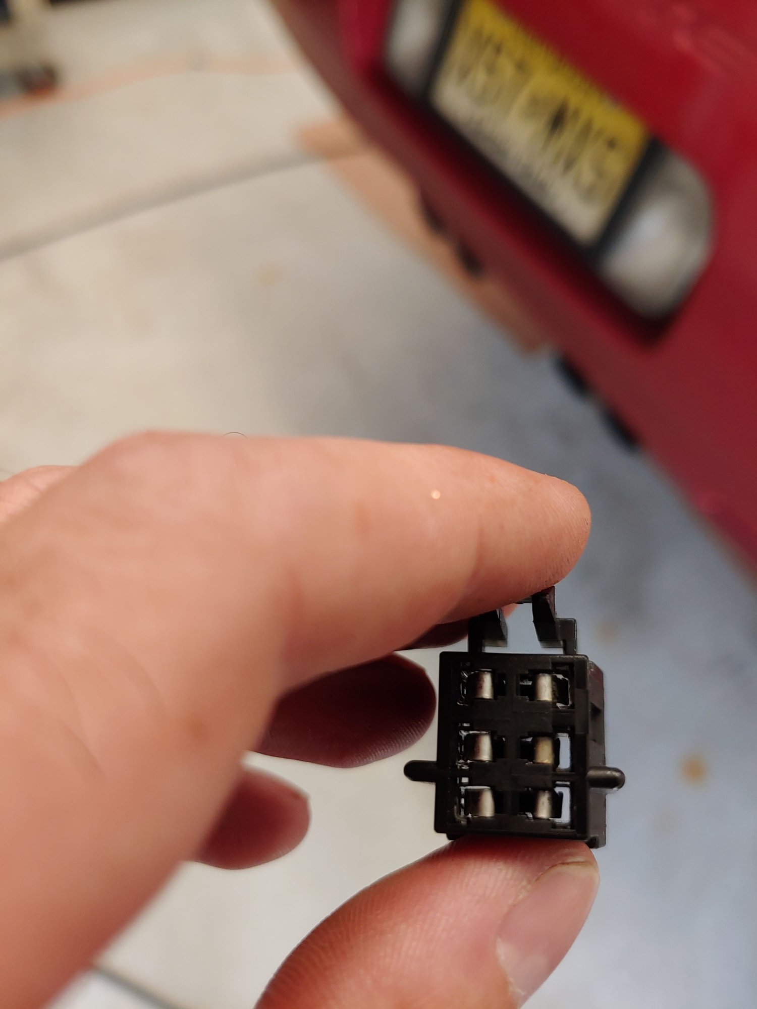

Check the electrical connector pins in the door jam accordion.

You may need to bend them back or try to replace. This was from my car (both doors acting up). This is very common.
If it's good check for power and ground in the connector. If that's good too move towards the driver door module.

The same thing happened to mine last year. I checked the electrical connector and sure enough two of the pins needed bent back. I did that and haven't had a problem since then.

I did bend the black wire connector back and then cleaned the entire connector with electronic CRC electronic spray. I came across that on Youtube U!
