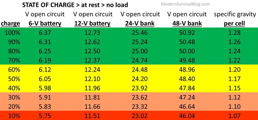

Old Jul 3, 2022 | 12:38 PM
jim993's Avatar
jim993
Joined: Sep 2009
Posts: 1,862
Likes: 594
From: Prescott, Arizona
FYI-
Old Jul 3, 2022 | 12:41 PM
rob-cyn's Avatar
rob-cyn
Joined: Aug 2007
Posts: 1,846
Likes: 129
From: Orlando Florida
Originally Posted by jim993
FYI-
Thanks so much
ok so this brand new battery at 100 percent charge according to my charger says 12.56 volts on my Fluke meter. Wondering if I got a weak battery
