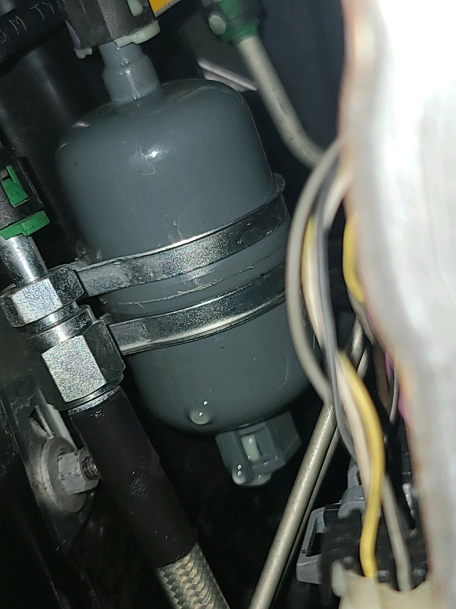

For the last few weeks the car wouldn't turn over when cold on the 1st try but would always start the 2nd time. The tuner took out 2 degrees out of timing and added 15% cranking fuel. Now if the car sits and idles for a few minutes and you shut if off it smells like a lot of fuel and it won't start for 30-40 min. I'm at a loss for what this could be unless it's related to the timing.

I’d put a fuel pressure gauge on the car and check pressure key on engine off and then how fast the pressure bleeds off…you’ll have to get underneath the rear of the car and see if there are any possible fuel leaks down there…also putting a scan tool on the car and looking at some live data…O2’s, fuel trims etc…if an upstream O2 sensor is “stuck” lean you will have a rich exhaust smell…happened to me ( bad O2 sensor) a few months ago but no trouble stating on the first try.

Well this could've turned out bad.
