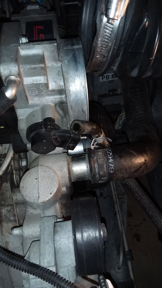

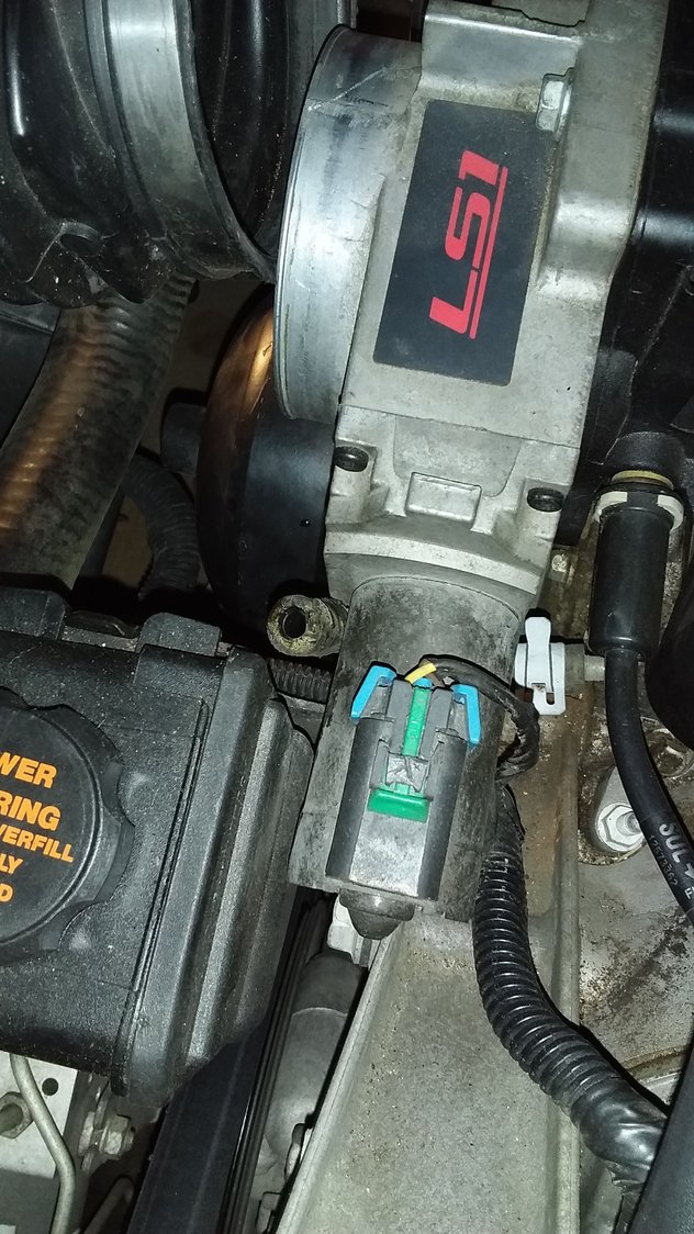

Okay, so, today, I did the throttle body bypass that ťhey say is good for approximately fifty or so horsepower. LOL I haven't posted on CF in a long time, so I thought I would do a " how to " write-up in case some noobs are interested.
Here is the hose connecter style 1/4 inch lead-free barbed coupling that I used. It was $ 3.10 at Home Depot

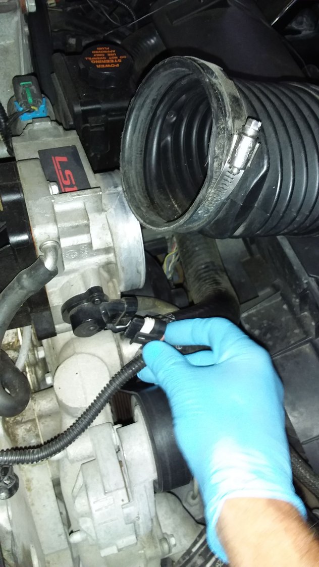

Disconnect the air intake at the throttle body to make space in order to work.
Disconnect the throttle body position sensor.

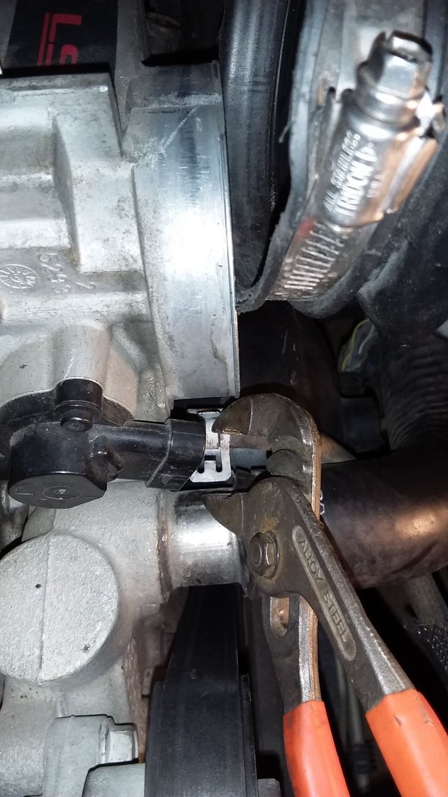

Disconnect the small coolant hose on the driver's side of the throttle body.
Disconnect the small coolant hose on the pasenger's side of the throttle body.

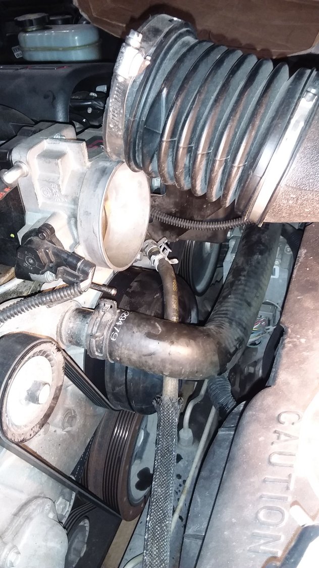

Attach both of the hoses, that you just disconnected, together, using the hose connecter style 1/4 inch lead-free barbed coupling; fastening and sealing each hose end to the brass coupling using the pre-existing OEM Corbin clamps.

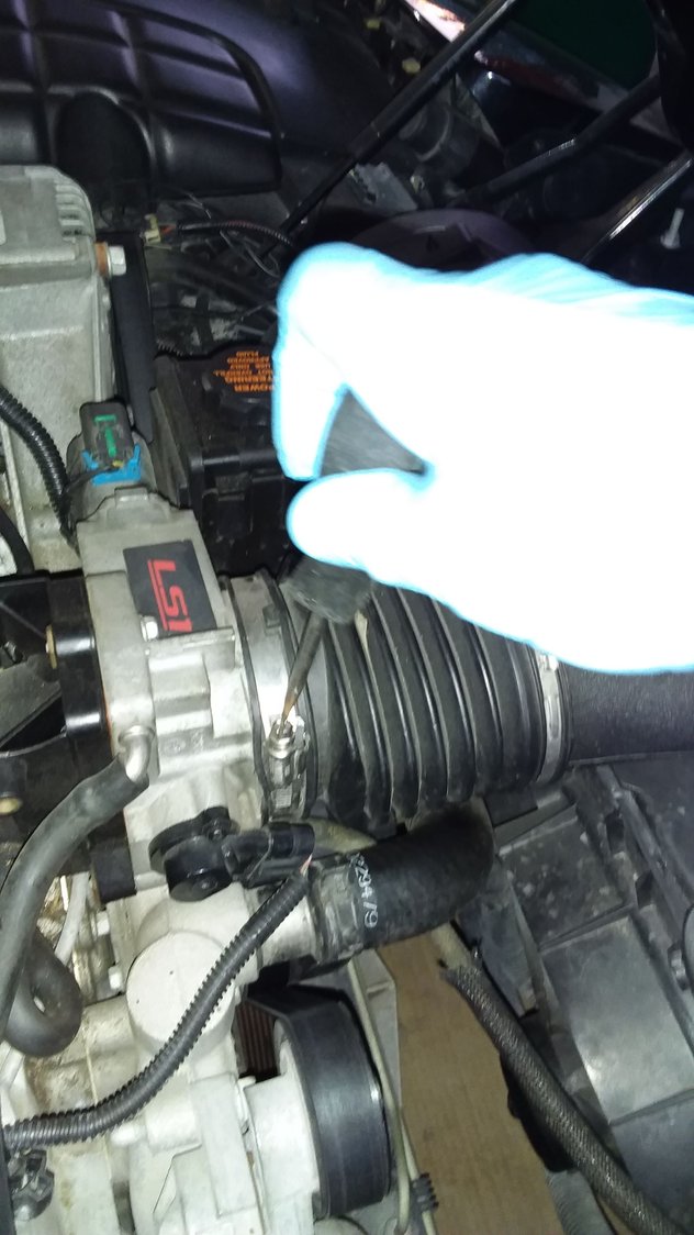

Reconnect throttle body position sensor.
Reconnect air intake at throttle body.
Cover the throttle body coolant inlet and outlet ports with 1/4 inch caps or plugs.
It only takes 20 mins. Either get the hose connectot at a hardware store or buy the throttle body bypass kit online. Good luck.

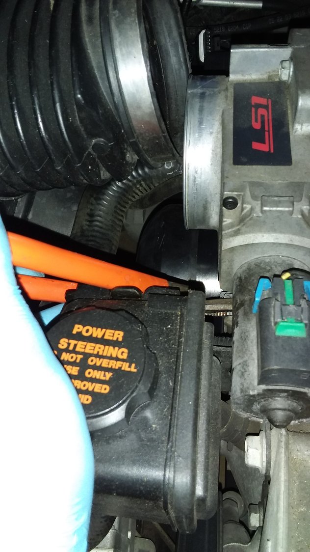

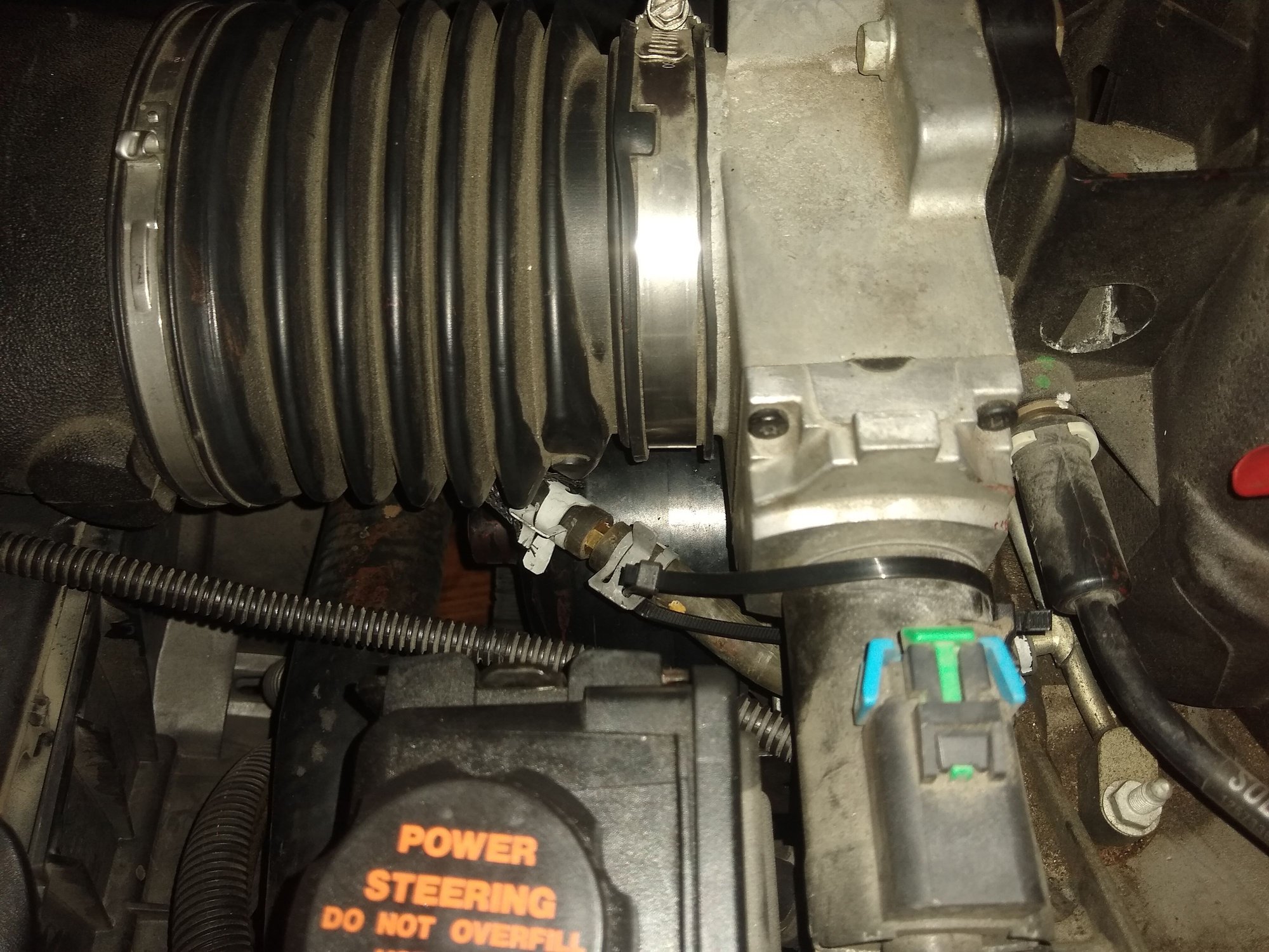

So I went ahead and did the mod- one thing to be mindful of is how close the hose and clamps are to the water pump pulley once you connect the two hose ends; the clearance is very minimal and will probably touch/rub on the pulley occasionally when hitting bumps in the road. So I oriented the clamps to face away from the pulley, and for piece of mind, also chained two zip-ties to keep it away from the pulley:
But, instead of this you might be better off by running a new long hose all the way from the radiator to the intake manifold barb, for simplicity. But, each end is a different size apparently (radiator end is 5/16" I believe and intake manifold end is 1/4" I believe, based on research I did from other threads).
Also, FYI, I used a 5/16" barb instead of 1/4".
