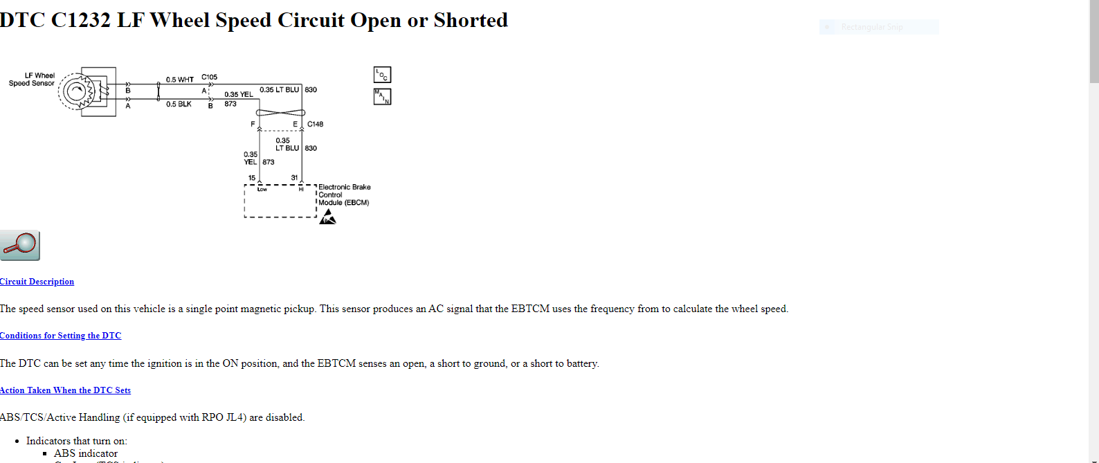

I have been trying to find the cause of the left front wheel speed sensor code for awhile. I did the voltage test which showed just over 2 volts, I checked continuity it was over 1100.
I replaced the cable from the sensor to the main trunk. I changed the whole hub just because. I cleaned three of the four grounding connections in the engine area. I only did three because I ran out of time. Does anyone know where the wires terminate coming from the sensor. I think it is at the PCM but it could be the EBCM. I cannot find a schematic that shows where exactly it terminates and which pins they are.
I would appreciate any help.

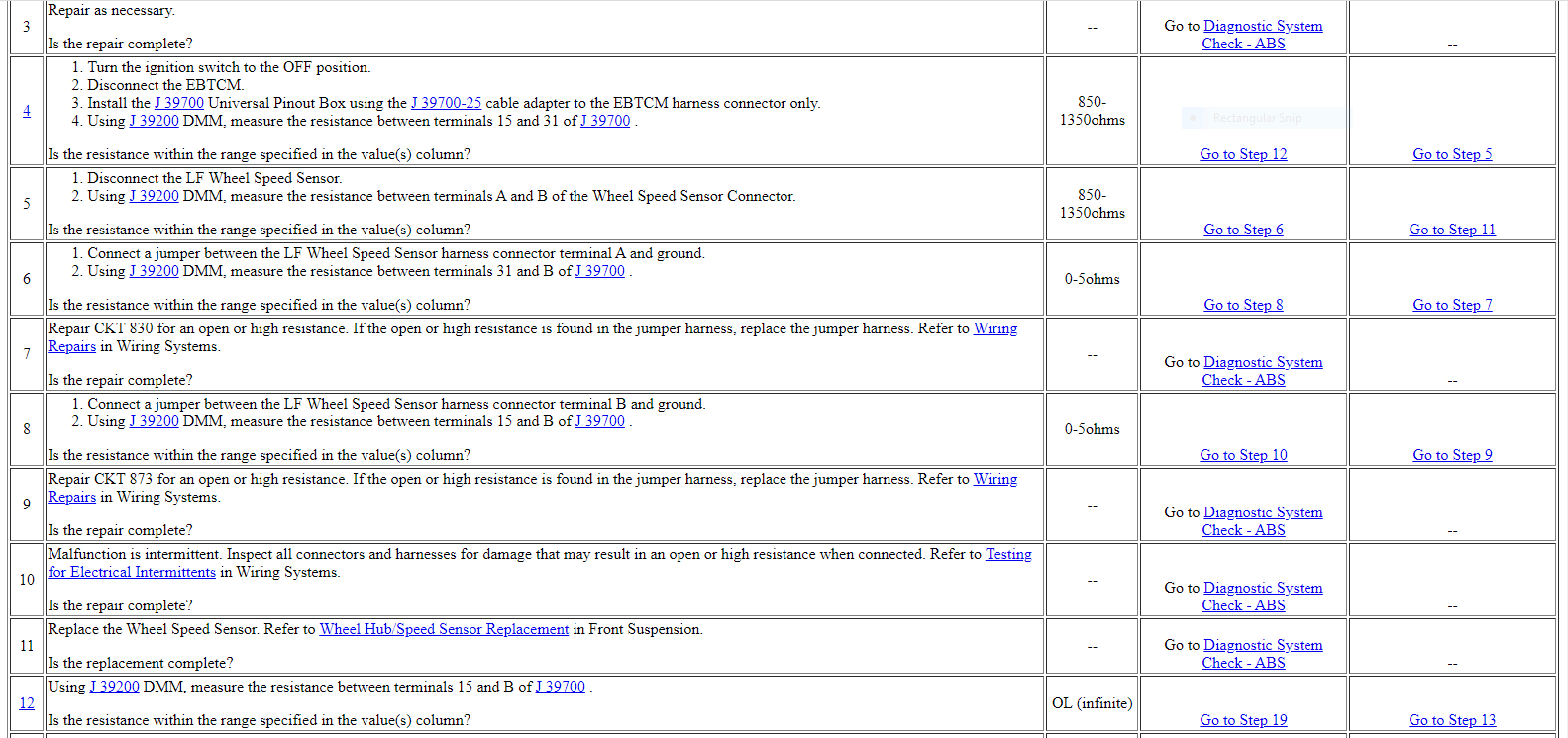

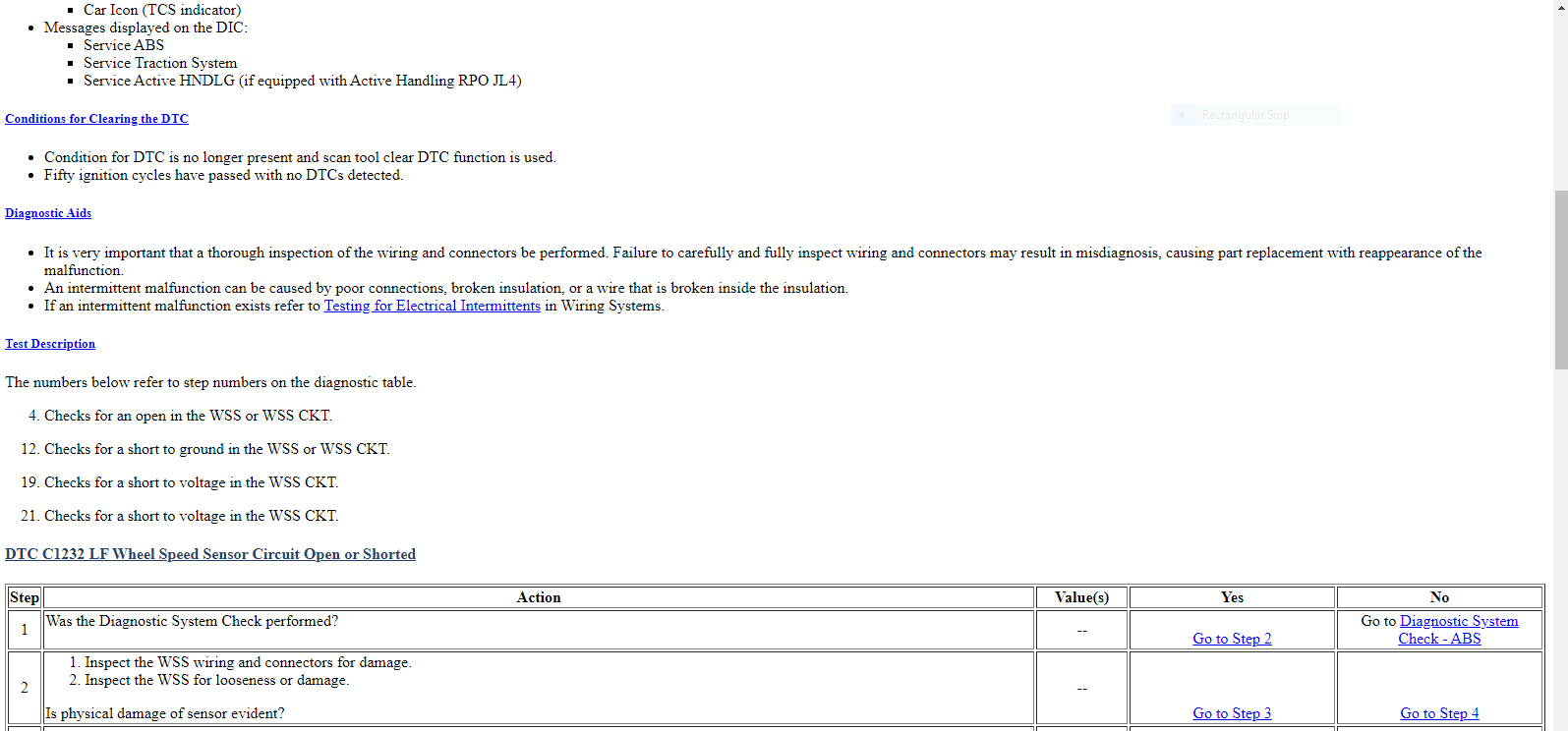

Below is the code from the service manual with the wiring schematic.
