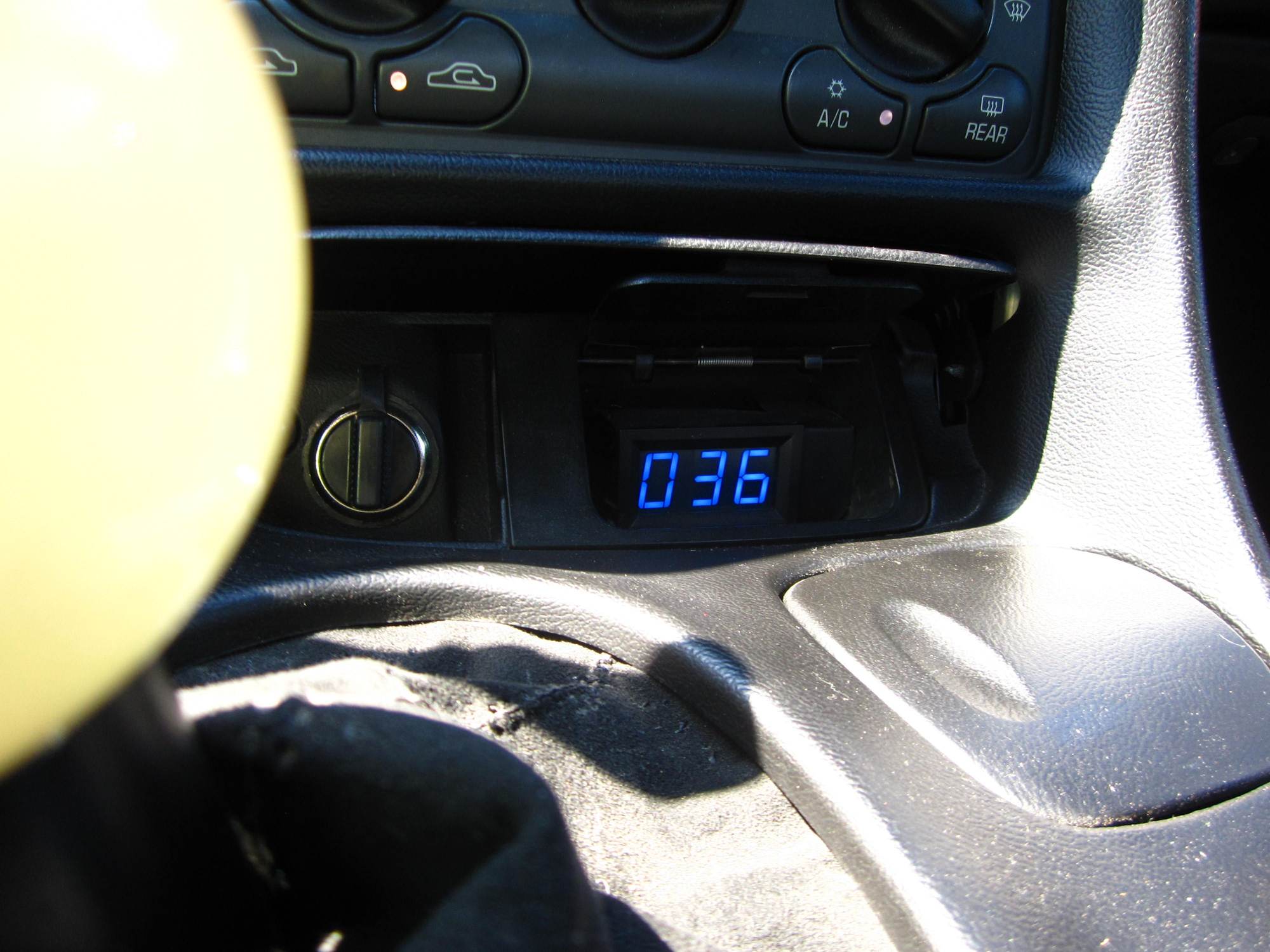

I did this last week, after the old parts including the condenser were removed, the remaining tubes and evaporator were flushed. The new compressor was shipped with 46 PAG oil and that was drained then 5 oz of 150 PAG oil was added to it and 4 oz to the new receiver/dryer since the system had no oil after flushing. The directions with the new compressor explained how to drain the old oil by removing the drain plug. The first can of refrigerant went in slow because the compressor clutch wouldn't turn on but after resting overnight the next day the pressures were up to 35 pounds and equalized so the clutch engaged to add the second can. The discharge air temperatures weren't very low until the next day when adding 2 more ounces of refrigerant as if the system needed to equalize again. Now the discharge air temperature is cold. One thing that was added last year was a digital temperature meter to the ashtray with the sensor in the discharge airflow out of the center duct. The meter was $9 from Amazon (Uctronics 0-167 F) and provides a nice check on the system performance while driving.
