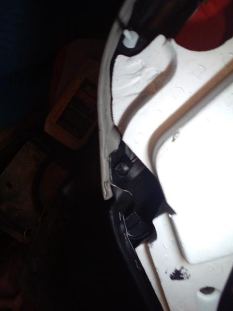

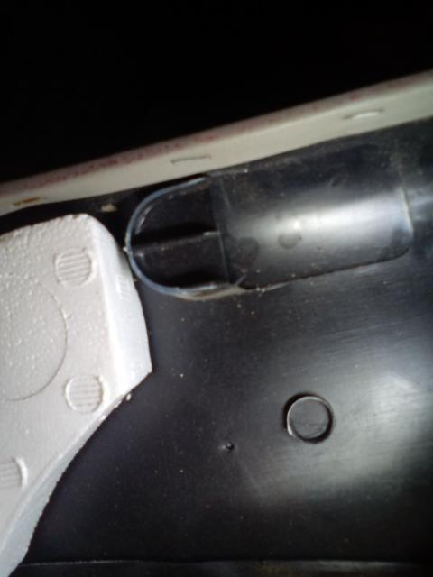

i have three broken door panel push clips on the backside of the door panels. Has anyone used the metal u clips they sell to fix this issue? How many are included in one kit and how do you go about mouting them to the door panel? I just shows the u clips in place against the plastic door panel but doesnt show how they are mount or how to install mount them to the door panel

I have the push clips the tangs that are in the door panel are broken that hold the push clips. I need the repair metal u clip retainers that attach to the door panel side that repair it. The only problem it doesnt show how to repair or attach the metal u clip retainers that hold the push clips in place. One set for a door panel is 20$. The push clips are on ebay 5 for 10$ something of that sort.

See 2 or 3 of these are broken on both door panels. They sell metal u tabs to fix this issue on the door panels on ebay but dont say how to mount them to the door panel. Are they supposed to be glued or plastic epoxied to the old abs plastic on the door panel? 2-3 of the plastic retainer parts are broken on both door panels. Ebay sells the metal u retainers to repair this issue on the c5 corvette door panels but doesnt show how to mold or mount them to the abs plastic see pictures attached. I was going to remove the door panels eventually to put ebays c5 precut window tint for 33$ but seen 2-3 are broken when looking under the door panels on both sides.

I removed all the door panel clips. The 2 bolts behind the door pull handle provide enough force to hold the trim panel firmly against the door.

I just did insolation on the door and broke 2 of them. I repaired one with plastic welding and the other with gorilla glue. Both repairs worked well. I also had a few broken white clips that push in the holes. I ordered some from Amazon prime. I also saw they had new window switch modules. Replaced them both for around 60.00
