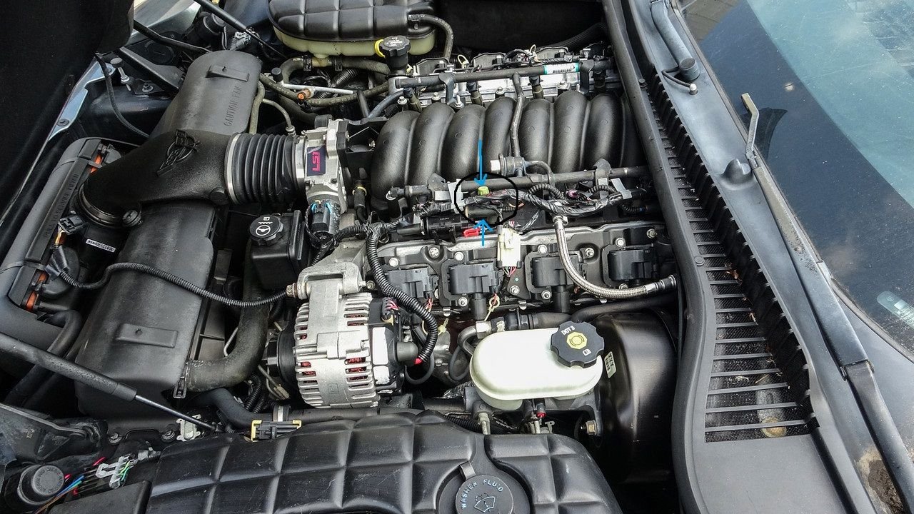

im looking for the part in the picture that connects to the vapor canister purge valve. that part in the pic with the green cap. i have no idea what its called and every search i make brings me to the part it connects to. might need to enlarge pic to see it properly.

That part with the green cap is the EVAP test port I guess you can call it...it's a Shrader valve under the cap and you would remove the cap and the needle valve inside or not to pressurize or leak check the EVAP system...it has left hand threads.

thanks, that hose that runs out the backside of that broke in half, so i need a new one.
