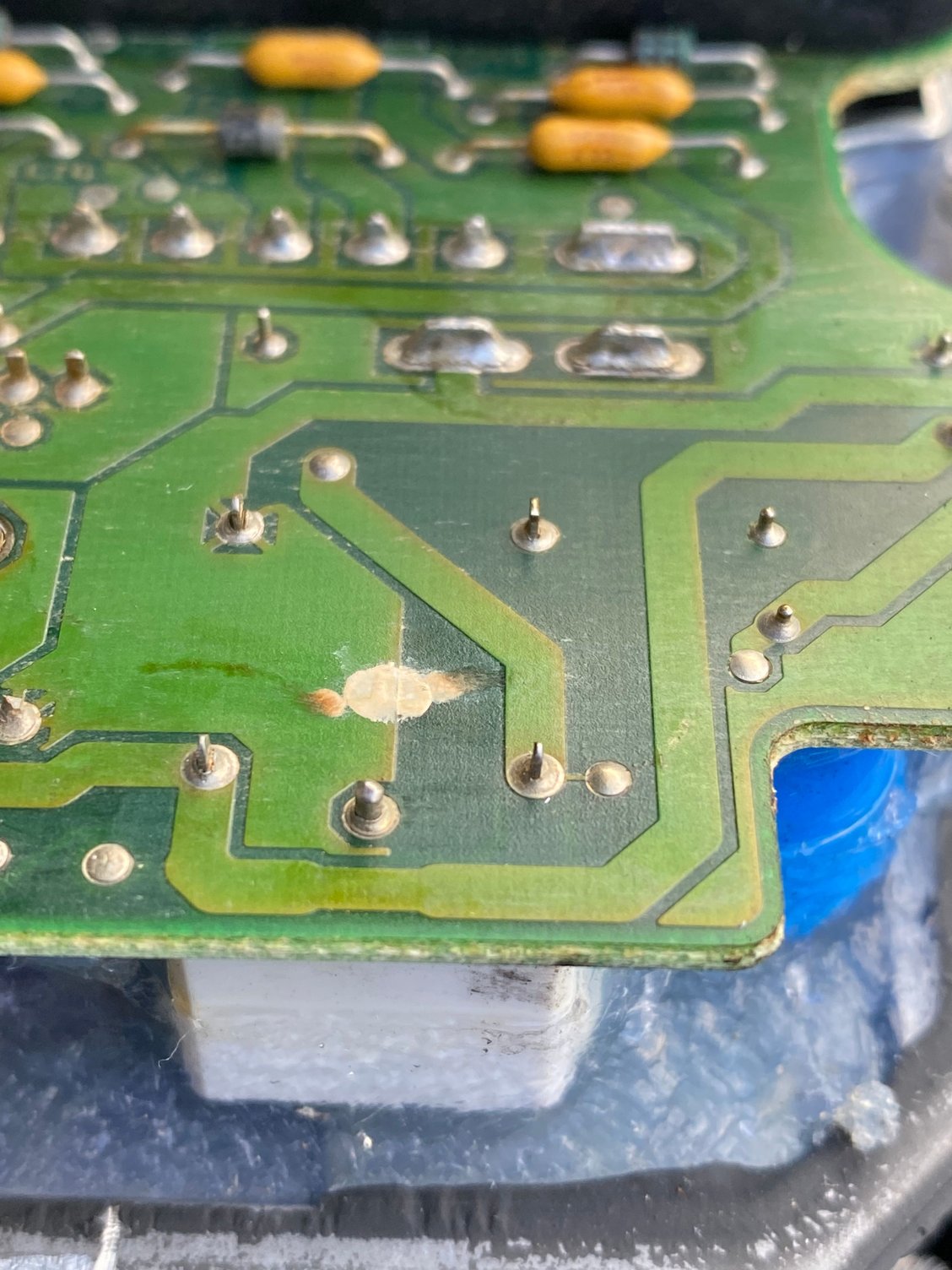

got 2 codes c1248,c1254, abs,service traction,stability messages and lights
so far I Cleaned all 4 grounds in engine bay.
do these solders look like they need re-soldering?

The big post in the bottom middle of the photo looks separated to me. Resolder on all of them should help.
