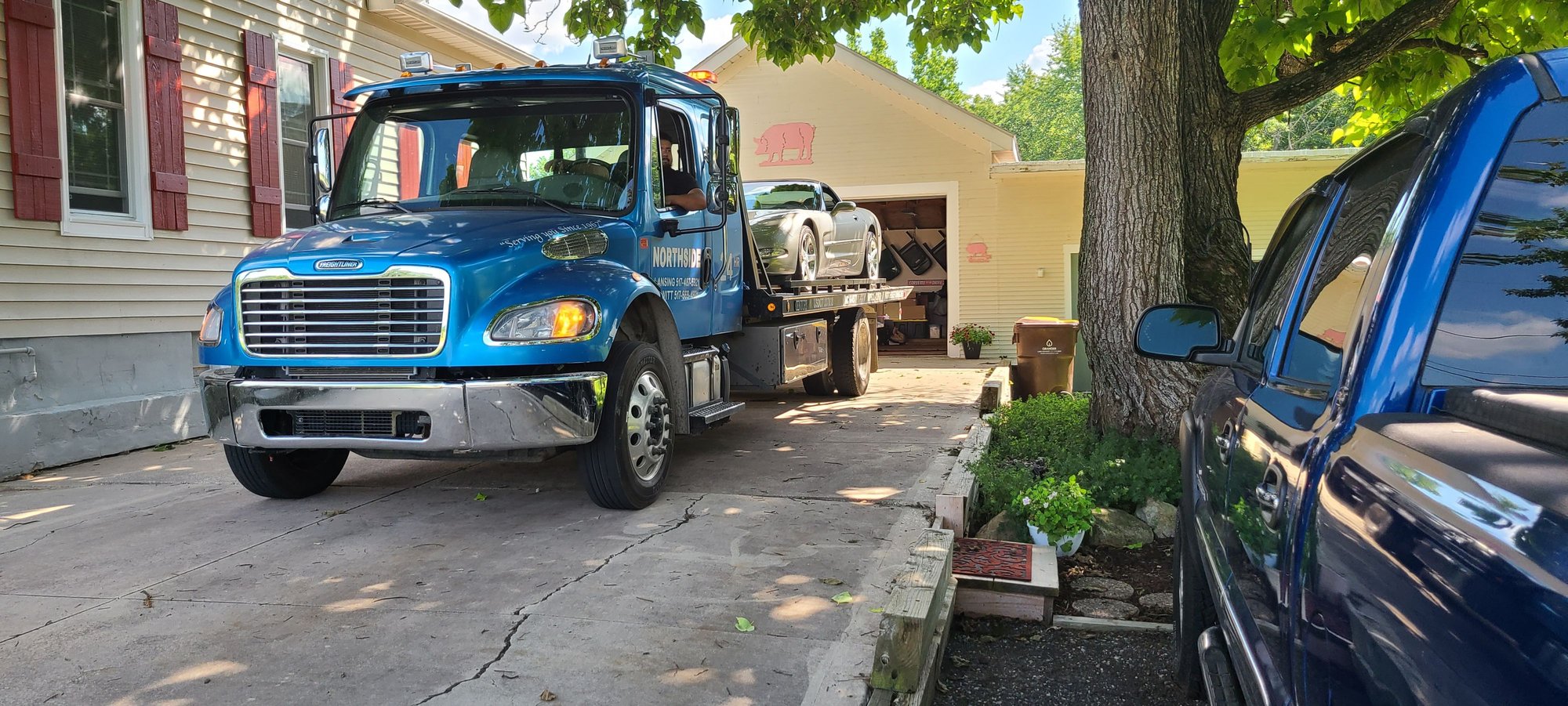

Got a light day at work, so stopped at the florist to buy flowers for my wife (25th anniversary today). Come out, try to start the Vette....nothing but "click click click". Tried jump starting it to no avail. Either dead battery or bad starter. Yay.

I do know how to jumpstart a car, guys. Sheesh. Tried that before calling the tow, and Vette would NOT take a jump. Towing guy didnt believe me, so he initially hooked up his large jumpstarter pack, and the car still would not start, just click click click. I did get it to turn over at home, but it would not fire. It did show the "low voltage" warning and seemingly every other DIC warning came up, too.
When you have perishables in the car, you do what you have to to get home as soon as possible. I also only have a small toolkit in my work bag, so I cant do major repairs on the side of the road.
I have towing reimbursement, so it cost me nothing but time and embarrassment
