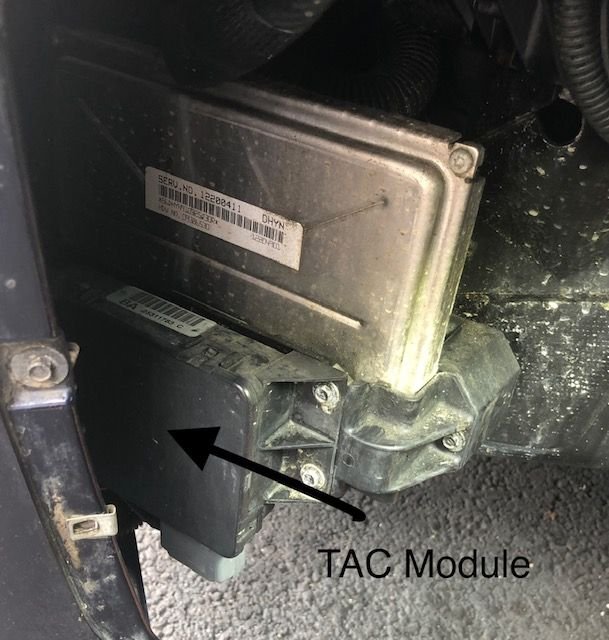

I'm referencing the wiring from my 01 and fuse 17 is the ignition feed to the TAC Module which sits below the PCM...there are 2 connectors and C2 which is the 16 pin connector is the one you want...the circuit number is 539 and I don't know what else it feeds from the TAC Module...perhaps the TAC motor which sits on the left side of the throttle body...I'd remove the C2 connector and see if the fuse blows...if it still blows you have a short to ground between the fusebox and the TAC module...you can start there...the wire run looks short between the Module and the fusebox so it might not be that difficult...the TAC module may have an internal short if the fuse does not blow after the C2 connector is removed...I don't see circuit 539 either going to the throttle body or the TPS or APP sensors...probably the first thing I'd do is remove the connector off the TAC motor and turn on the ignition and see if the fuse blows.
