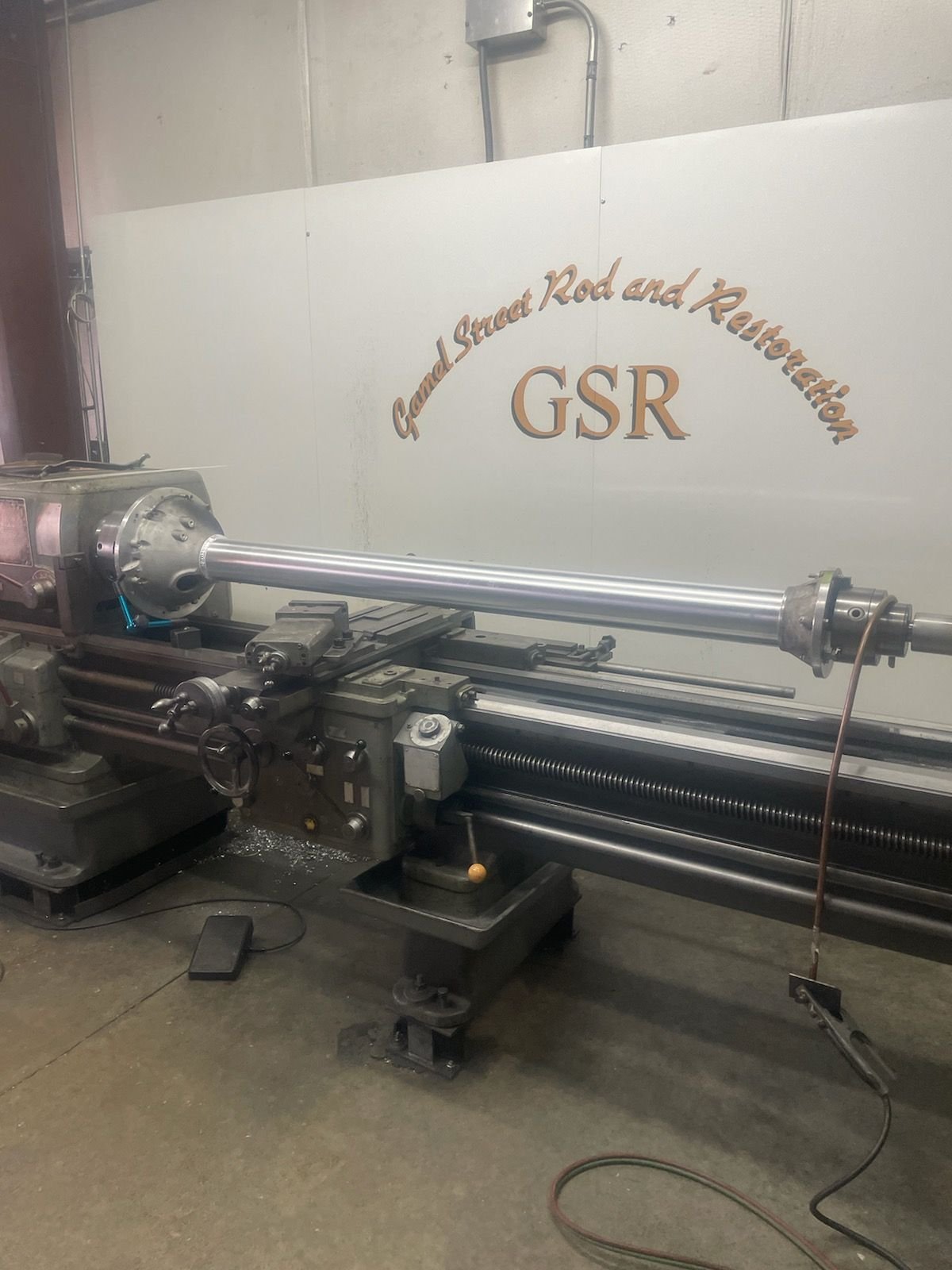

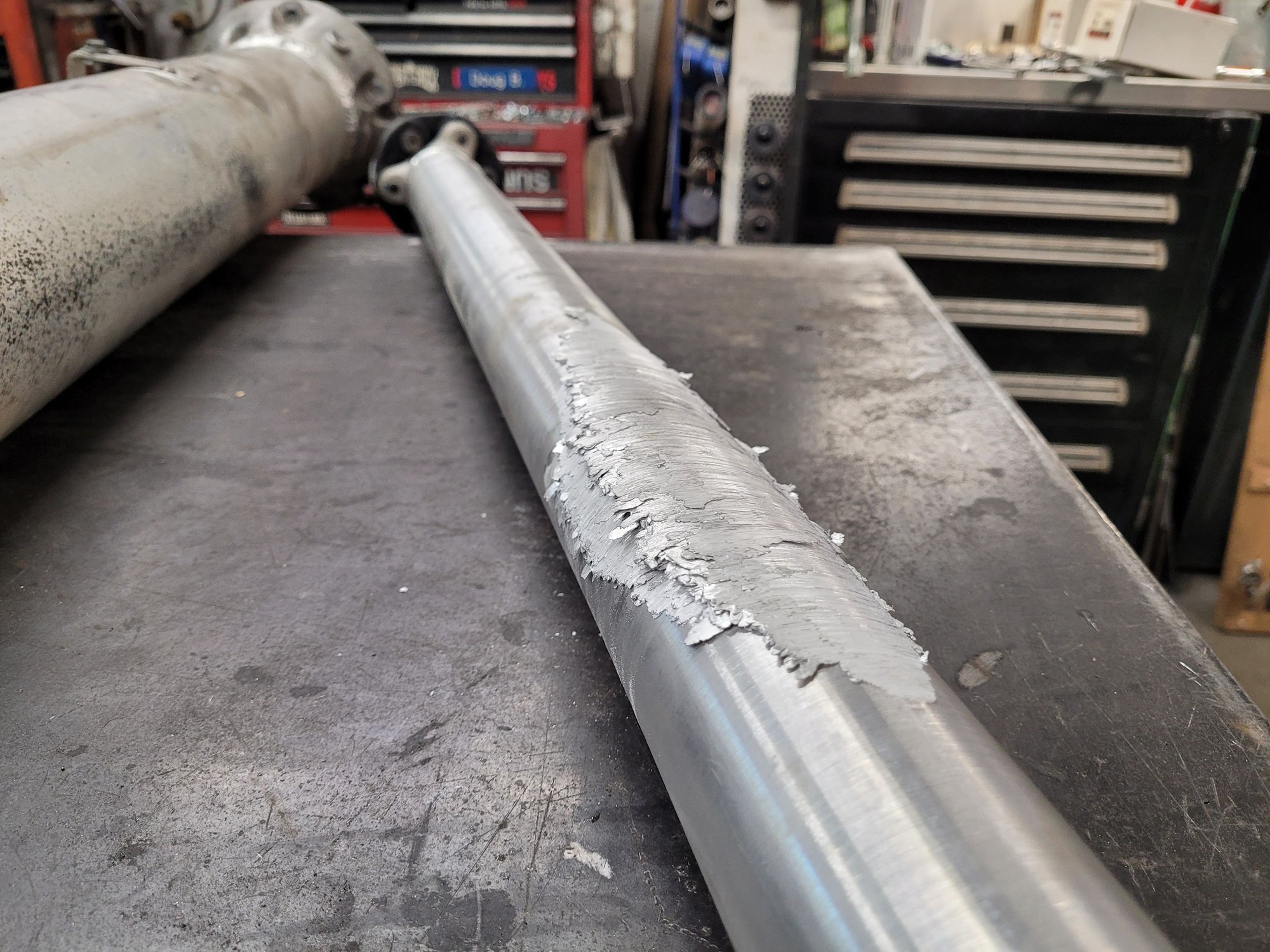

Well, pulled the torque tube this morning... im not sure if this would cause a vibration... should be okay. Im gonna put it back together and continue to try to find the cause of the vibration. Haha! I'm hilarious. So, to do the hassis swap, I had to extend the tt & shaft by 10.5". I wonder if the longer shaft made out of the same tube would have some flex, enough to tweak it? I will talk to driveline guy and maybe use a heavier tube. I have 1" of clearance in tt. Heavier is better right?

Wow! I have some homework to do! Here's what I know. Took it in today and buddy showed me the original "stock" shaft. Also showed me the tube he used ...6061 aluminum 2" sched 80. I think it was .218 wall. Waaaay thicker than the stock tube. Not sure how 10.5" adds to the problem. He's re tubing it for now and maybe I should settle down a bit on the throttle lol! I did see those 3" aftermarket ones, and if I am determined to drive like an idiot, I will need one haha! Thanks for the advice and I will look up the words I don't know.

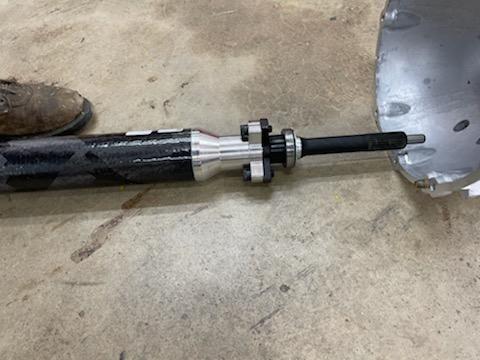

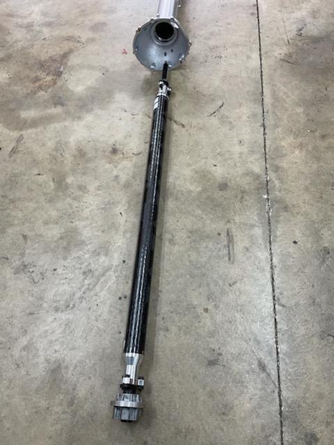

I did a similar swap 2003 ls1 t56 vette
extended TT 20.75 inches
Had to run a quad wrapped carbon fiber impeller shaft
