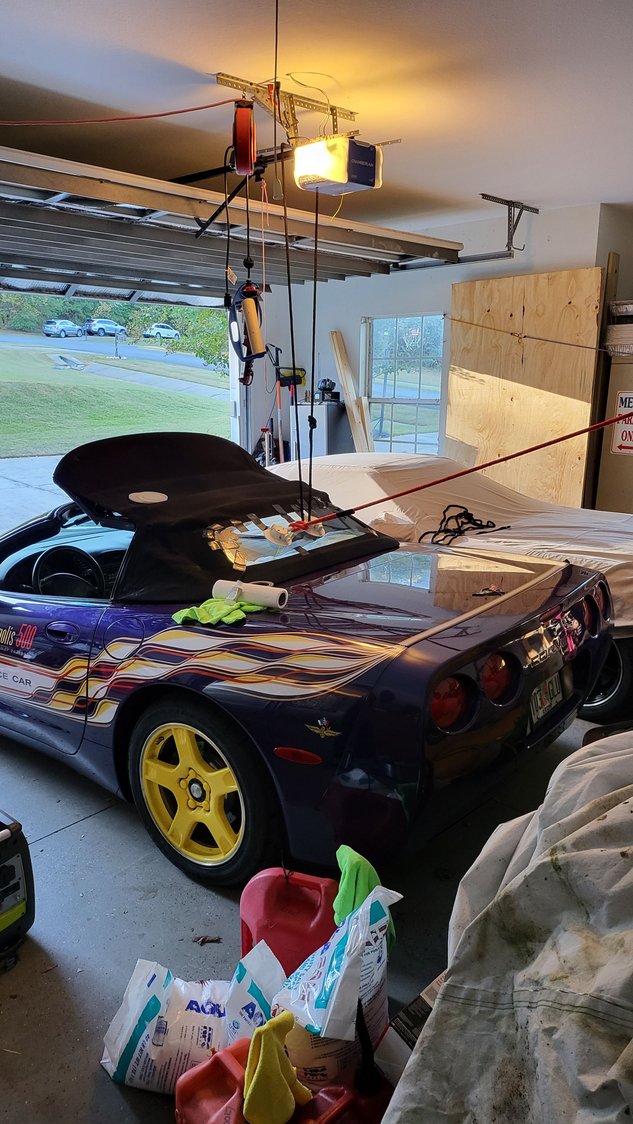

This job is a royal PITA. I'm on round 2. First job with rhino glue lasted about 7 years. This is current situation pic so I can post back later on how round 2 goes. It won't be as nice as round 1 because extra dried glue is around but if I can seal it for 5 more years then I'll get a new top!

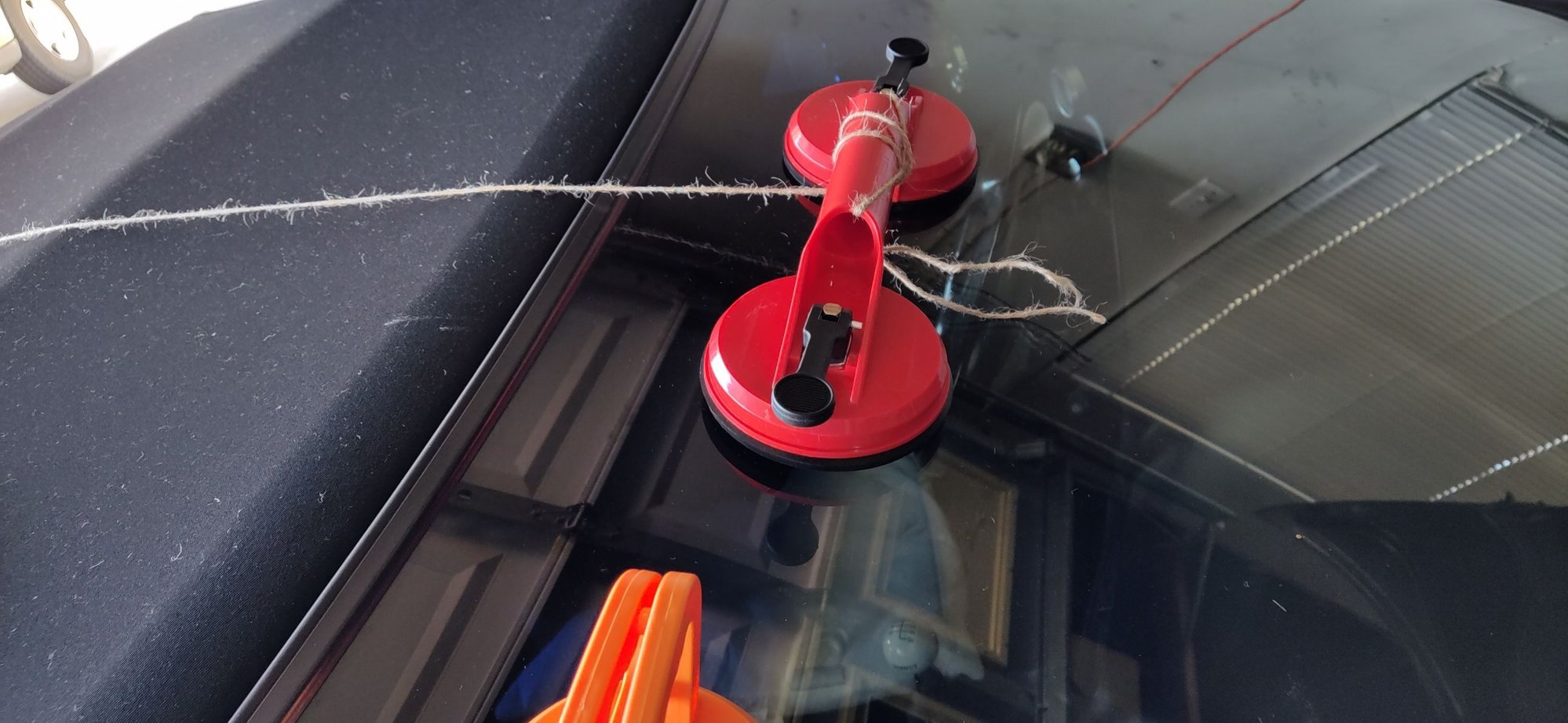

I used 3m window weld and you see how it oozed out after pressing the fabric. I tried to used popsicle sticks to clean up but nope. It's like trying to move tar. Way easier to clean up and trim after you let it set for 45 min with a razor blade.
The orange and black suction cups are tied with twine that's going over the trunk lid and wrapped onto two 25lb dumbbells. This is just to lift the glass. Dumbbells are in trunk. YES those are two pillows inside keeping pressure on the glass.
The silver dual suction cup is tied to the red dual suction cups to align the glass in place. This is the last time I buy those single suction cups from HF as two sets of 3 DO NOT even work. They SUCK but not on glass.
