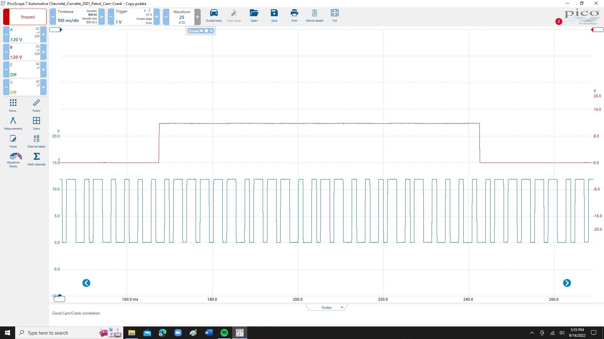

Well I hope they ordered OEM sensors and not junk aftermarket such as Dorman for instance...you should ask them to verify you'll be getting OEM...seen many issues here with aftermarket sensors...make sure they check the wiring on these sensors before they install a new one or ones...power, ground, and signal...even with a new sensor using a scope to make sure it is working properly is essential...this is what a good cam sensor looks like with a scope (red trace)...blue is the crank sensor...they should verify signal is going to system voltage and fully to ground…have a great weekend !!
