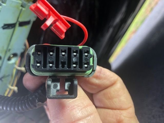

Do you know where the TAC module is located...below the PCM...??...pic below...I'd remove the 2 connectors and get some contact cleaner and spray both and then reconnect...make sure there are no bent or spread terminals...I would start there. If no luck and you know how to graph live data with your scan tool while you are trying to replicate the problem I would look at RPM, TPS voltage, MAF, MAP, APP, Load, Fuel Trims and O2 sensors...when you graph notice when that RPM drops and see what other sensors may be affected during the RPM drop. Always a good idea to include your location...you may be a neighbor...there are MANY Corvettes in Southwest Florida.
