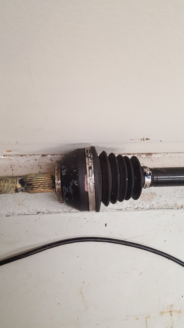

We replaced an axle last minute on a buddys C5 with a part store one and the next weekend on track the boot exploded and took out a rear brake line. I re-used the axle but put some smaller Camaro boots on it from the Drive Shaft Shop and filled with good AMSOIL grease. Been fine for 2 years now.
If you get a part store axle at least replace the boots and put decent grease inside.

here's a couple pics of the bad axle boots I ran into that would balloon and take out the brake lines, the Aftermarket doesn't have as many the pleats in it
Aftermarket boot
Factory boot

They dont list them on their site but call the Drive Shaft Shop in NC and ask for the 5th gen Camaro axle boots. They smaller diameter than C5 and better rubber that doesnt crack and explode at high speed. I keep a spare set in my trailer in case one of the low mile OE axles goes bad on my car.
