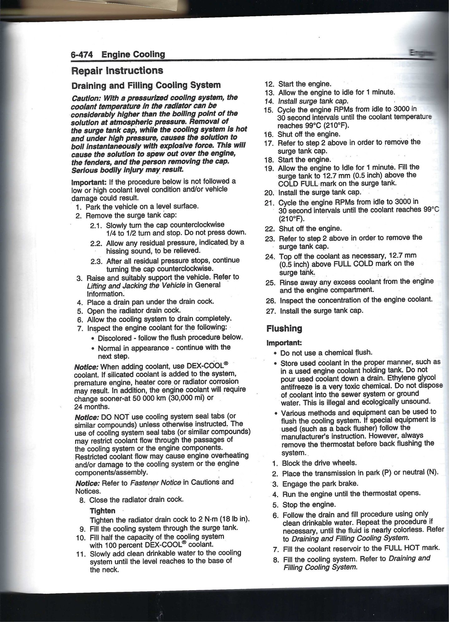

Is a coolant pressure test something I need to do when I get the pump replaced? And do I mix distilled water with coolant or put 50/50 in there? I live in norCal, car won't ever see temps under 8c

You should also replace the gaskets and thermostat. Follow the Factory Service Manual for filling, getting air out of the heads:
