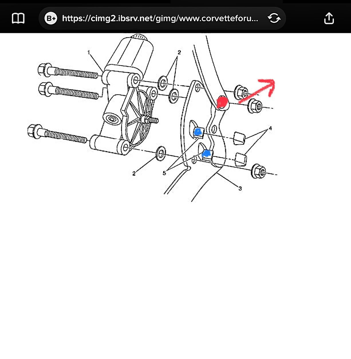

Old Sep 15, 2022 | 09:42 PM
vette4fl's Avatar
vette4fl
Joined: Feb 2021
Posts: 6,524
Likes: 4,369
From: Florida
Originally Posted by corvettezman
As mentioned above. Check and see if the arm is pivoted to the wrong side. May need to move it 180 degrees. My money is that the arm is not installed properly. Don't ask me how I know.
I did it wrong too …. Same problem.
The pivot (red) points to the back. You might have just got lucky on the second try…
Make sure the lower arm is behind both of the plastic stop tabs (blue) and it should be ok.
