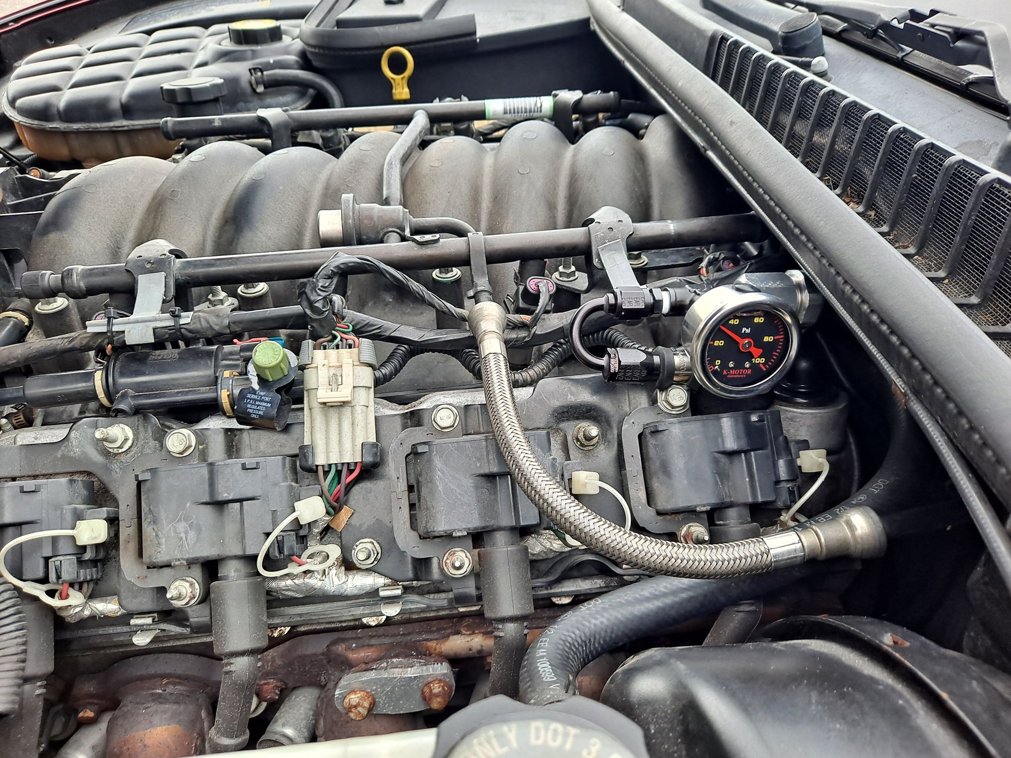

I plumbed my OPS to have a gauge in line and it runs 3-4 lbs higher than my DIC numbers. Thinking the gauge might be wrong I installed another gauge in its place and the results were the same 3-4 lbs. My 27lbs hot OIL pressure showed 30-31 on the gauges.

Your oil pressure sender has failed.
Consider relocating it so that the next time it fails, replacement is a ten minute job.

Get a decent aftermarket sender. I usually like to stick with OEM replacement parts for stuff like this. But its obvious the OEM oil sender isnt all that good. I bought a cheaper, non lifetime warranted sender (one year warranty) at O'Reilly 6 or more years back, and it's still there.....

I added a gauge so that the next time it failed, I knew the engine had good oil pressure.

^^ Very common mod, I also did this to mine. Not only can one see the actual pressure it also makes changing the sensor a quick job seeing the manifold does not have to be removed.
