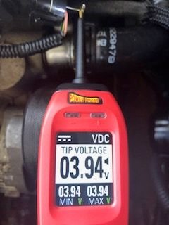

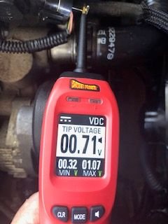

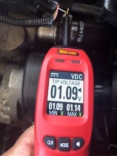

First I would check the 2 signal voltages at the TPS sensor with a DVOM...how did you know what the correct voltages are ??...the voltages should be these per the FSM and this is with the throttle plate manually closed and opened
TPS1 -IDLE- 0.13-0.67v WOT - 4.09-4.87v
TPS2 -IDLE- 4.3-4.8v WOT- 0.13-1.0v
These are what I saw KOEO and just pressing the accelerator down to WOT...I'd compare the reading at the sensor vs. the scan tool...see if you see the same voltages at the TAC module with your DVOM...pins 1 and 11 on the C2 connector.

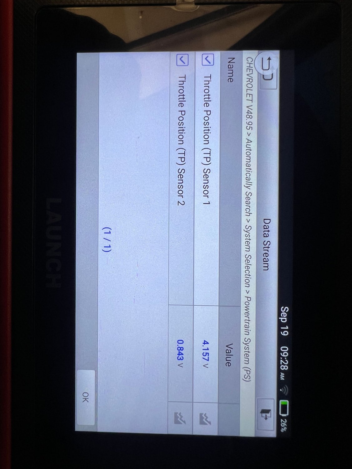

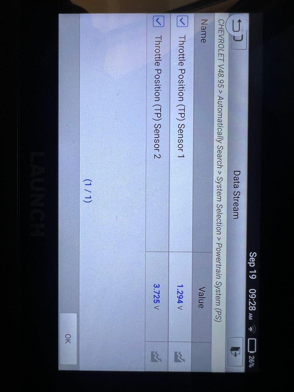

I recorded the data streams for both sensors while slow pressing and releasing the gas pedal with ignition on and engine off. When I completely let go of the gas pedal, sensor 1 is at 1.294v and sensor 2 is at 3.725v consistently.
when I floor the gas pedal, sensor 1 is at 4.157v and sensor 2 is at 0.843v consistently
It looks like our TPS1 voltages are a little off but like I said the numbers in the FSM are physically pushing the throttle plate opened and closed...have you see if you have any deposits on the TB bore ??...you can manually open the plate and use some TB cleaner (I.ve always used Brake Kleen) and see if the numbers changed...did you try wiggling the connector while looking at the scan tool ??
