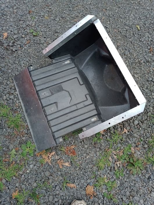

I think the video your looking for is this one
I did this a few months ago to my car, mine is a race car but it also has to be street legal. Most of the rear carpet is still in place the only carpet piece not in place at this time is the piece that covers the removable part eventually I will have velcro strips glued to the trunk and carpet to hold the removable carpet piece in place.
https://www.youtube.com/watch?app=desktop&v=lxrMcJ54NJ4
I didn’t know about this video, what I saw was a picture of someone pulling their differential out of car with rear subframe still in C5.
This is much better!
So, with your tub removed, can you pull out the differential without dropping the subframe?
If yes could you pull out the transmission and torque tube also to replace clutch?
Another question is would it be easy to pull the drive train with crossmember in place, or much more complicated because the cross member is in place and in the way, I realize this might be something that cannot be answered if it has not been tried yet.
For the average C5 owner who may only do 1 clutch job for the life of ownership it’s probably a lot more work than just dropping the rear subframe and everything , but I just like the idea it’s possible to do the clutch job or diff swap in a much easier quicker way.
One more question for anyone who has replaced C5 clutch, do the rear upper control arms need to be unbolted to allow room to pop out the inner CV shafts from differential, or is that only done to remove the complete assembly of rear subframe/cradle?
"So, with your tub removed, can you pull out the differential without dropping the subframe?"
The quick answer yes, but you still have to remove the upper a arms to pull out the shafts. If you go that far you might as well just pull the rear subframe.
"If yes could you pull out the transmission and torque tube also to replace clutch?"
Yes, see above.
"Another question is would it be easy to pull the drive train with crossmember in place, or much more complicated because the cross member is in place and in the way, I realize this might be something that cannot be answered if it has not been tried yet."
It would be more complicated with the subframe in place and It's not that big of a deal to remove the subframe. I don't think I would even try it with out pulling the subframe first. I've lost count of the number of times I've pulled the drivetrain out of my car, if I remember correctly it's been 3 times this year alone.
"For the average C5 owner who may only do 1 clutch job for the life of ownership it’s probably a lot more work than just dropping the rear subframe and everything , but I just like the idea it’s possible to do the clutch job or diff swap in a much easier quicker way."
When it comes to changing any thing in the drivetrain on these cars there is no quick or easy way. It's a pain in the *** no matter what you do.
With the tub removed you don't have to angle the drive train any were near as much as you do with the tub in place.
"One more question for anyone who has replaced C5 clutch, do the rear upper control arms need to be unbolted to allow room to pop out the inner CV shafts from differential, or is that only done to remove the complete assembly of rear subframe/cradle?"
See above

I used a peal and stick foam as a seal on the aluminum mounting pieces for the tub. With a cordless screwdriver it takes me about 2 minutes to pull out the tub.
