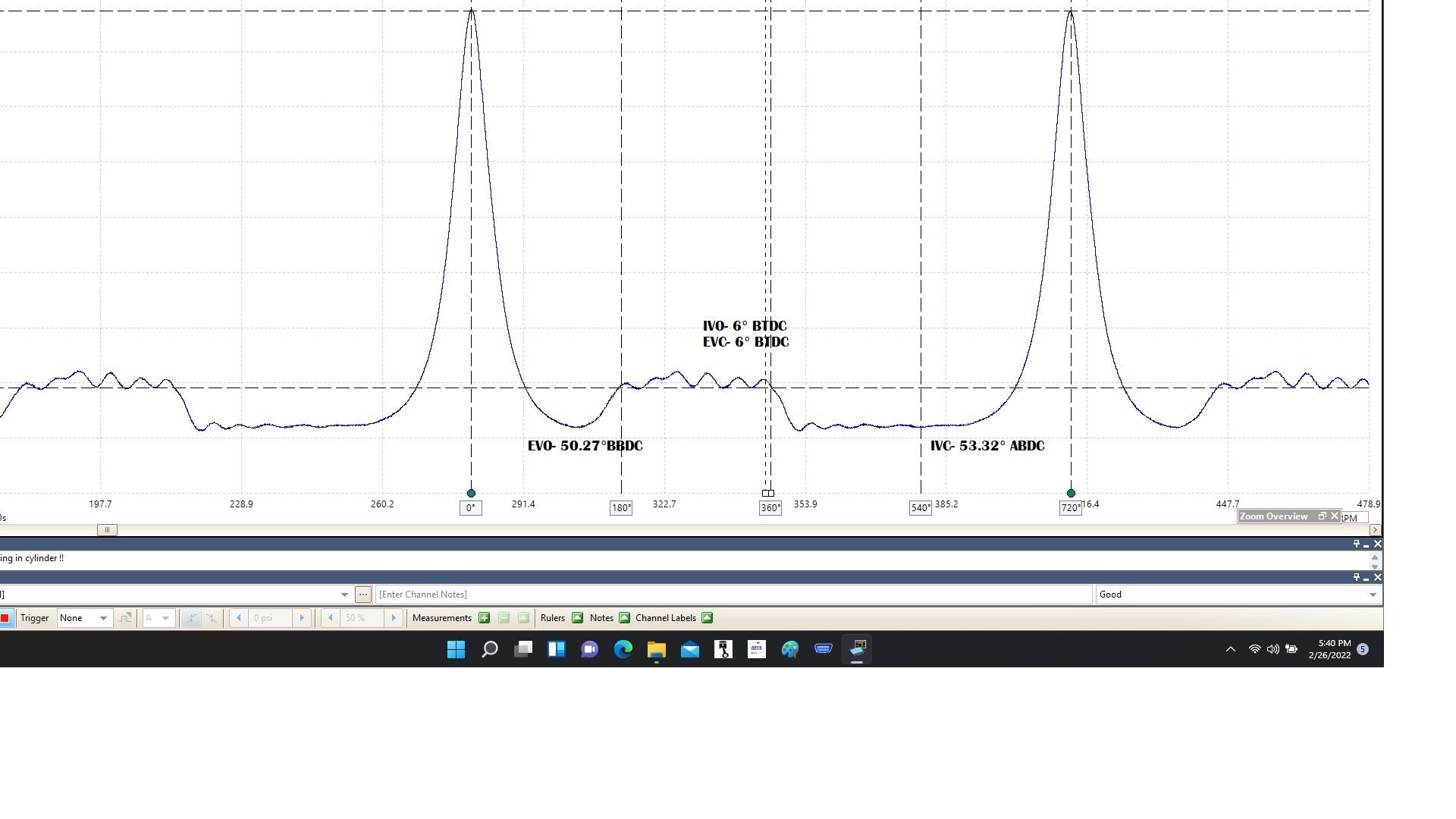

Originally Posted by Fast one
How sloppy can an LS engine timing chain get before it needs to be replaced and is there an easy way to check how loose it is? The second chain was installed about 60,000 miles ago and it had some slop when new. Can a too loose chain cause recurring long cranking before starting as if the cam and crankshaft position sensors go in and out of sync?
Yes, a sloppy chain can cause some issues since it will cause the camshaft timing to be retarded or late…the easiest way to check is with a pressure transducer installed into any cylinder and looking at the waveform and comparing it to one that is good but 1 in a thousand shops know how to do this…this is the timing numbers I performed on my 01 a while back.
