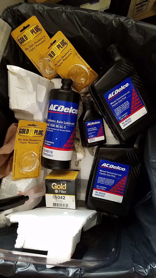

I was under 50k miles on a 1998 when I bought my car in March, 2022. 24 year old car...I couldn't make up my mind so I went with the OEM stuff. AC Delco price is all over the place on the web. My closest local Chevy dealer closed about a decade ago. (My childhood home was across the street, worked there in high school). I ended up getting fluids on ebay, seeking free delivery at the best price. All fluids in the pic below came from GM dealers that sell on ebay.
