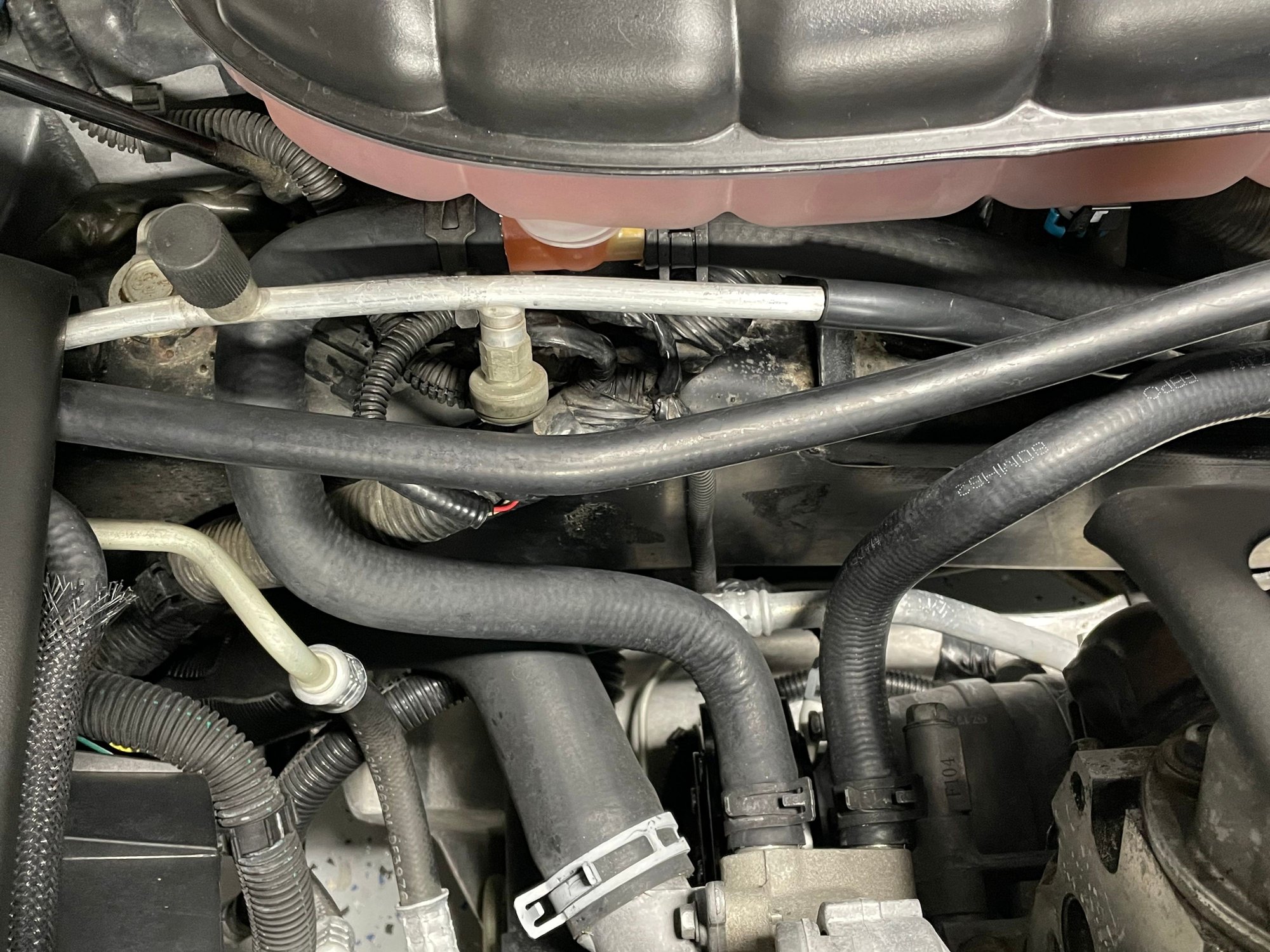

Hello, I have a 1998 Corvette, In July I replaced all of the water hoses, clamps, and a new surge tank and cap. I have a leak at the heater outlet hose (the one that goes back into the tank) at the surge tank and it drips a couple drops a day.
I replaced *again* (Labor day) the hose and put a new clamp on... and the leak continued. I used the gates 5/8 safety stipe hose and a 24mm constant tension clamp same as original.
I think I done something obviously wrong here? Nothing else is leaking, my car has around 50k miles. Do I have a defective tank somehow or do I just need a screw clamp or plumbers tape lol, what is the thing to do?

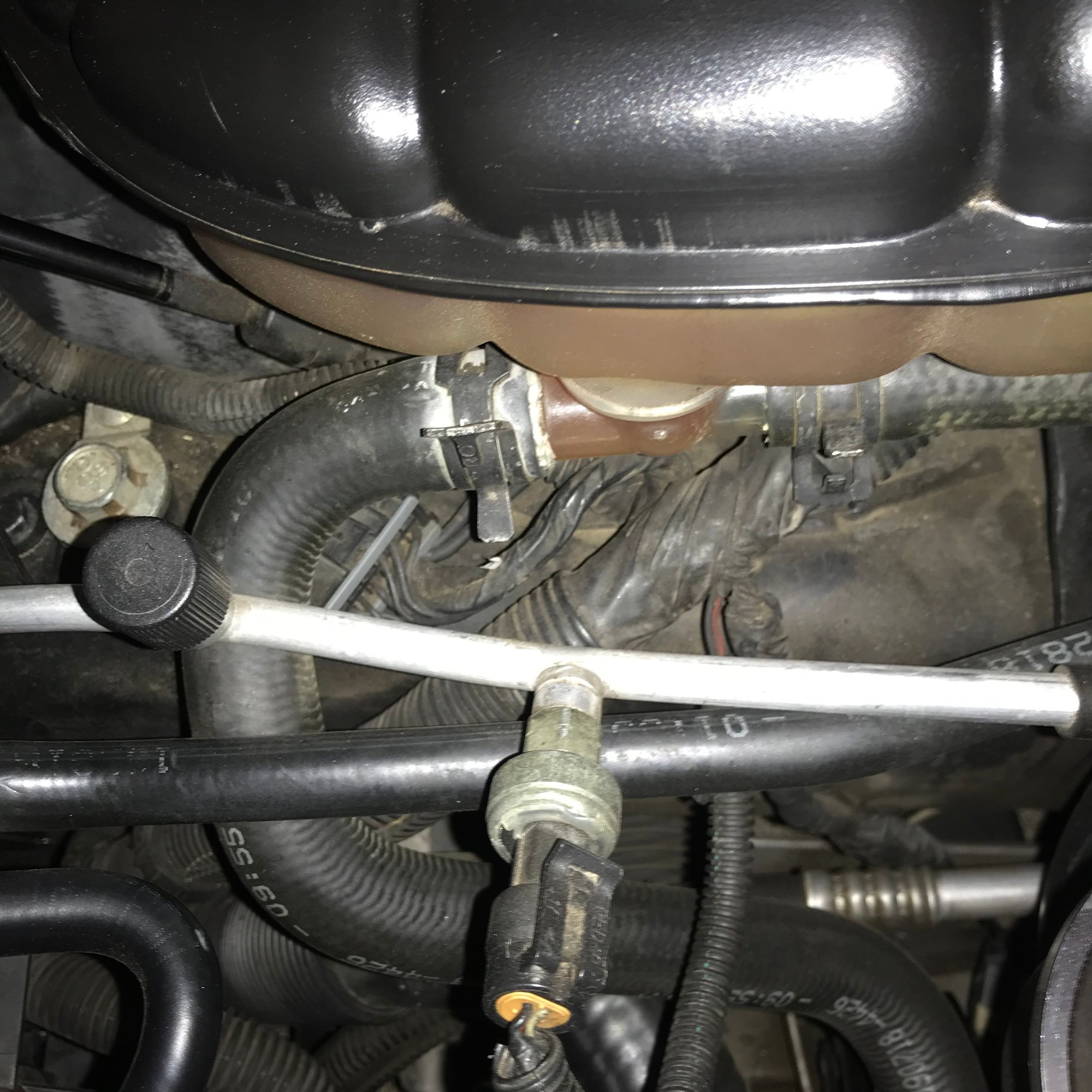

I had the same exact problem. Tried multiple new tanks and different hoses. Wind up having to use a little bit of sealant. I’ll post a pic later.

I’m not sure. My shop had to do it. It looks like a grey sealant that hardened into a plastic. You can see it around the hose in this pic. I’m super OCD so this bothered me. But we tried everything and this was the only solution.
