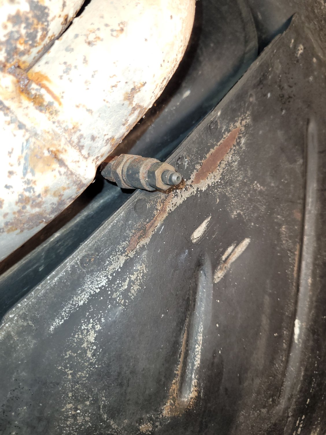

Does this look like a speed bleeder or a regular bleeder? I've never dealt with a speed bleeder.
A remote bleeder and speed bleeder are the same thing, just different ways to call it. So you should be able to crack open that bleeder (only need to open it about 1/4-1/2 a turn), and it should have a check valve in it that won't let the fluid just come running out. If for whatever reason it does start running out as soon as you open it, then you would need a second person refilling the reservoir while you were underneath doing the remote bleeder, to make sure the reservoir never gets fully empty and sucks in air.
The bleeder should be higher, if nothing else for convenience. I don't want to put the car on stands just to blow some clean fluid through.
Agreed, my remote bleeder is routed so I can just stick a water bottle on mine and bleed the clutch all from the top.

I agree with both of you. I will relocate the end of the remote bleeder to the top of the engine before I fire it up, but this is the way I found it as it was when I bought the car. It was probably boiling the fluid all the way up to the slave cylinder, since it's laying about 1/4" from the header collector. The clutch would barely disengage at all.

So this is the old fluid. My son helped me today, and we bled and changed the fluid today with DOT4. Although I still can't fire it up for a road test quite yet, I can already tell the clutch is going to work much better.

Might want to check that remote bleeder hose routing. I've heard of a few rare cases where clutch hoses have burned through and caught fire with longtubes. It also isn't doing any favors to the fluid being that close to the header.

Yes, I'm going to reroute the remote line up to the top before I fire it up again!
