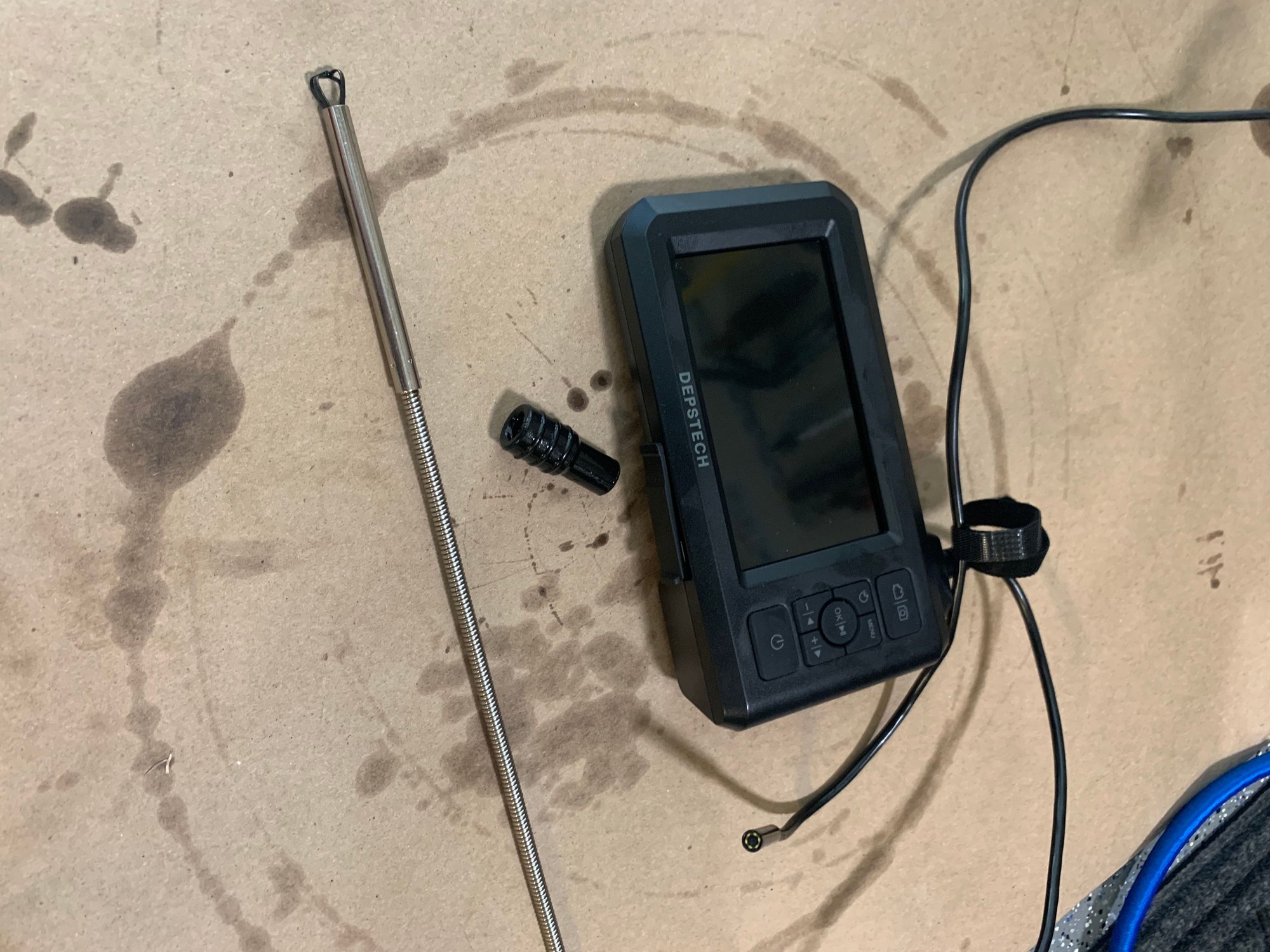

There are times, exceedingly rare, when men are able to accomplish feats beyond human comprehension. Man’s first steps on the moon, Brady’s 7th Super Bowl victory, are a few that come to mind. Today is such a momentous day. For today is the day I successfully fished this little rubber ******* out through the fill hole in my differential using a $60 Amazon borescope and one of those bendy claw retriever things. All is right with the world.
