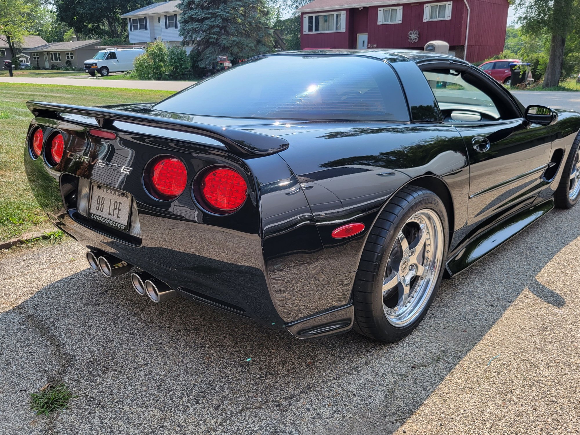

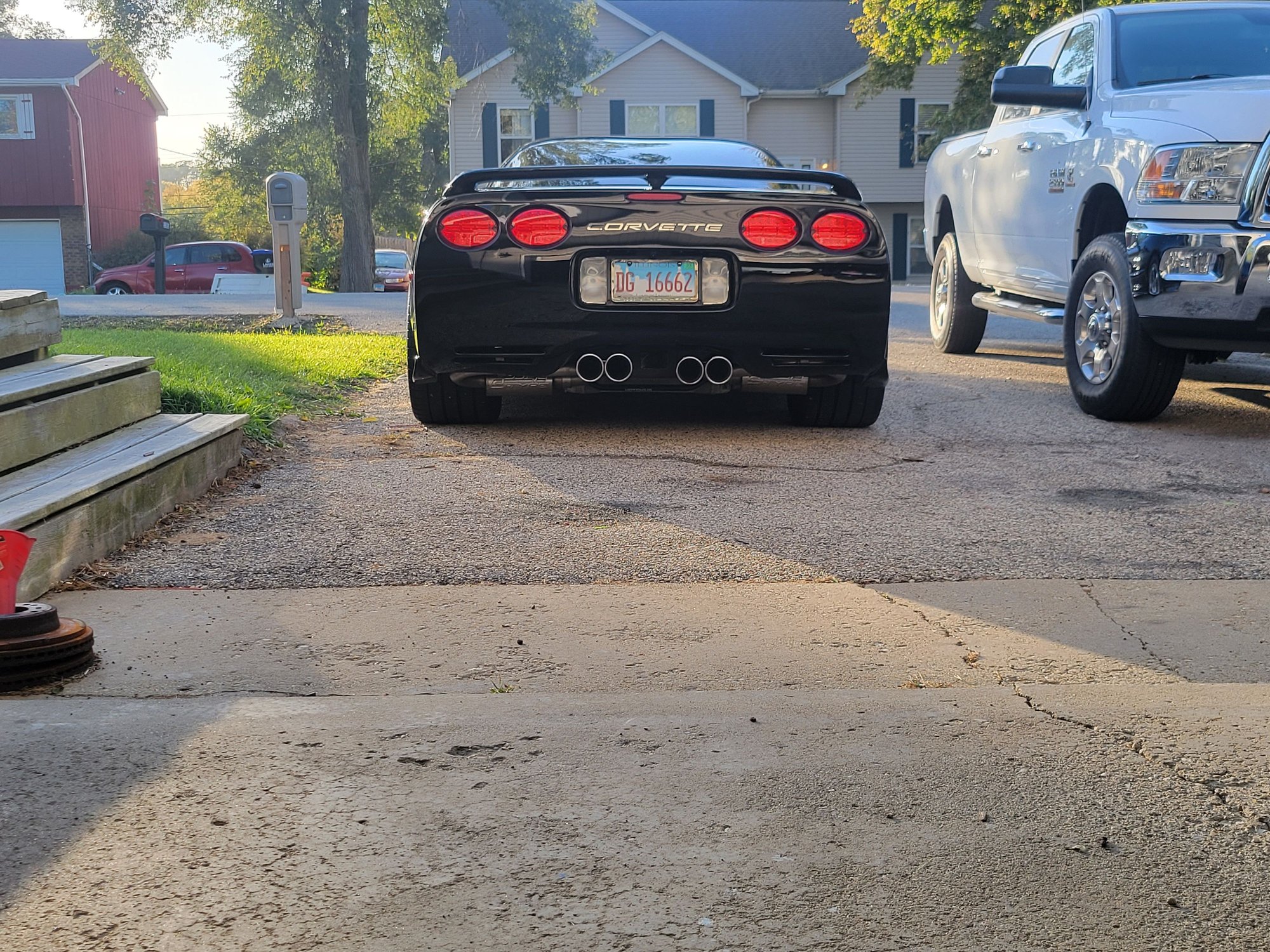

Originally Posted by Tusc
Oh hey - I am REALLY curious. Do you have any photos of how they did the mini tub setup? Very cool car.
Don't have any pictures .
Use to be able to see them from inside rear of car when carpet is lifted ,but I layerd down the sound insulation over the entire back end .
I run 315/40/19. With zero rubbing.
