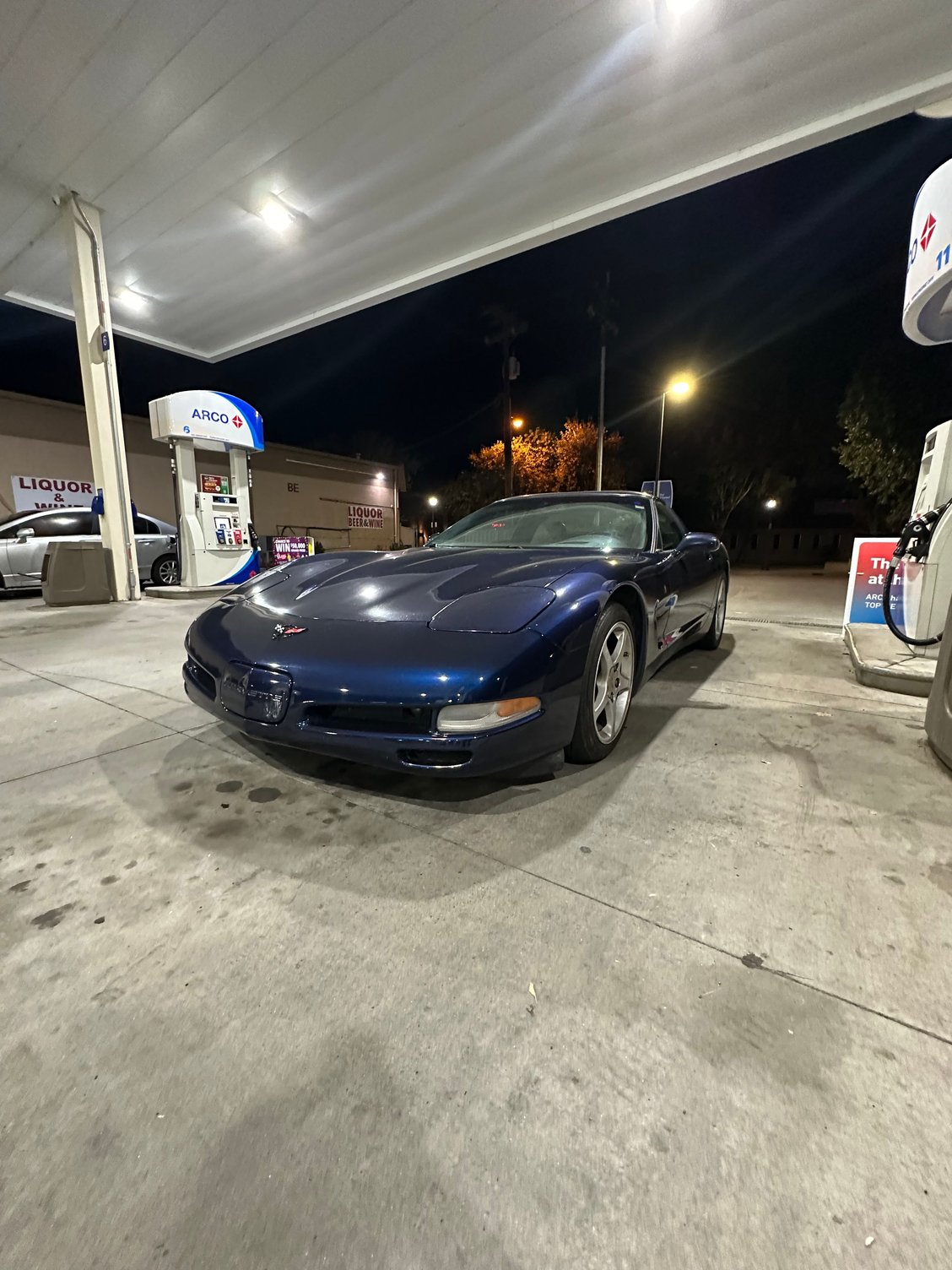

I have tried doing some research and can’t really get a clear answer in regards to wheel hop. When it’s dry outside and I gun it the wheels spin and I come into a little wheel hop which isn’t pleasant but not terrible. When it’s raining out side totally different story-
Giving the car gas and getting on it in the rain feels like the car is going to just explode. The rear end hop is the worst I have ever experienced in any car. All I can find is people mentioning better tires, well I want to enjoy the LS1 with rear wheel drive and burn some tires off but with the wheel hop I don’t want to damage anything serious to the drivetrain. Does anyone have any experience themself on how to help correct this? I’m buying a solid differential mount once I sell old parts from my old car and fingers crossed that helps.
Any help is appreciated
