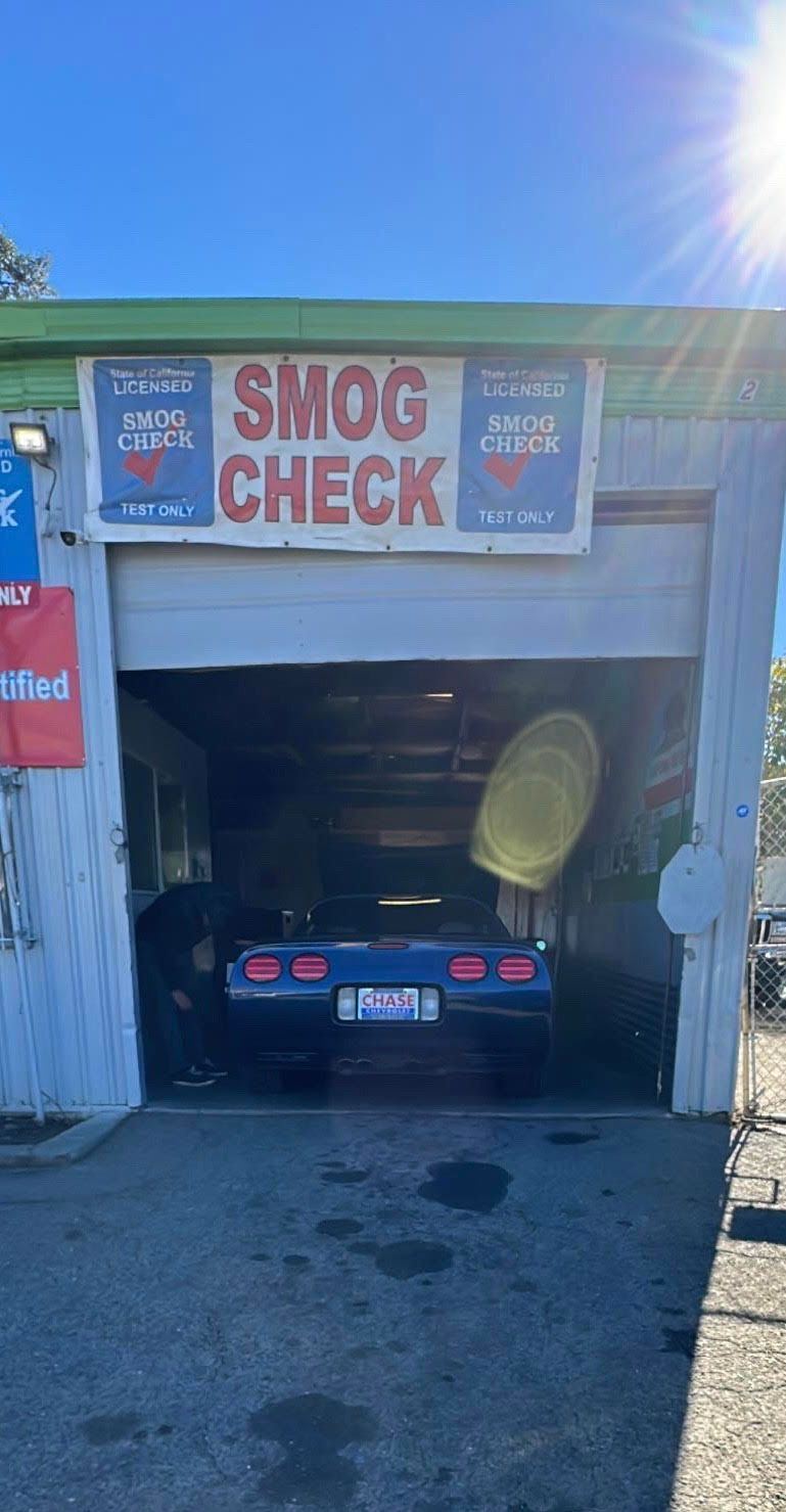

Yesterday I took my C5 down to have the SMOG check done so I can transfer into my name and the monitor for the catalyst and secondary air system were not ready
I have drove a bunch after the check valves were replaced and still not ready, I guess I have more driving to do? Does anybody have any experience with getting these monitors to be good to pass emissions testing in California?

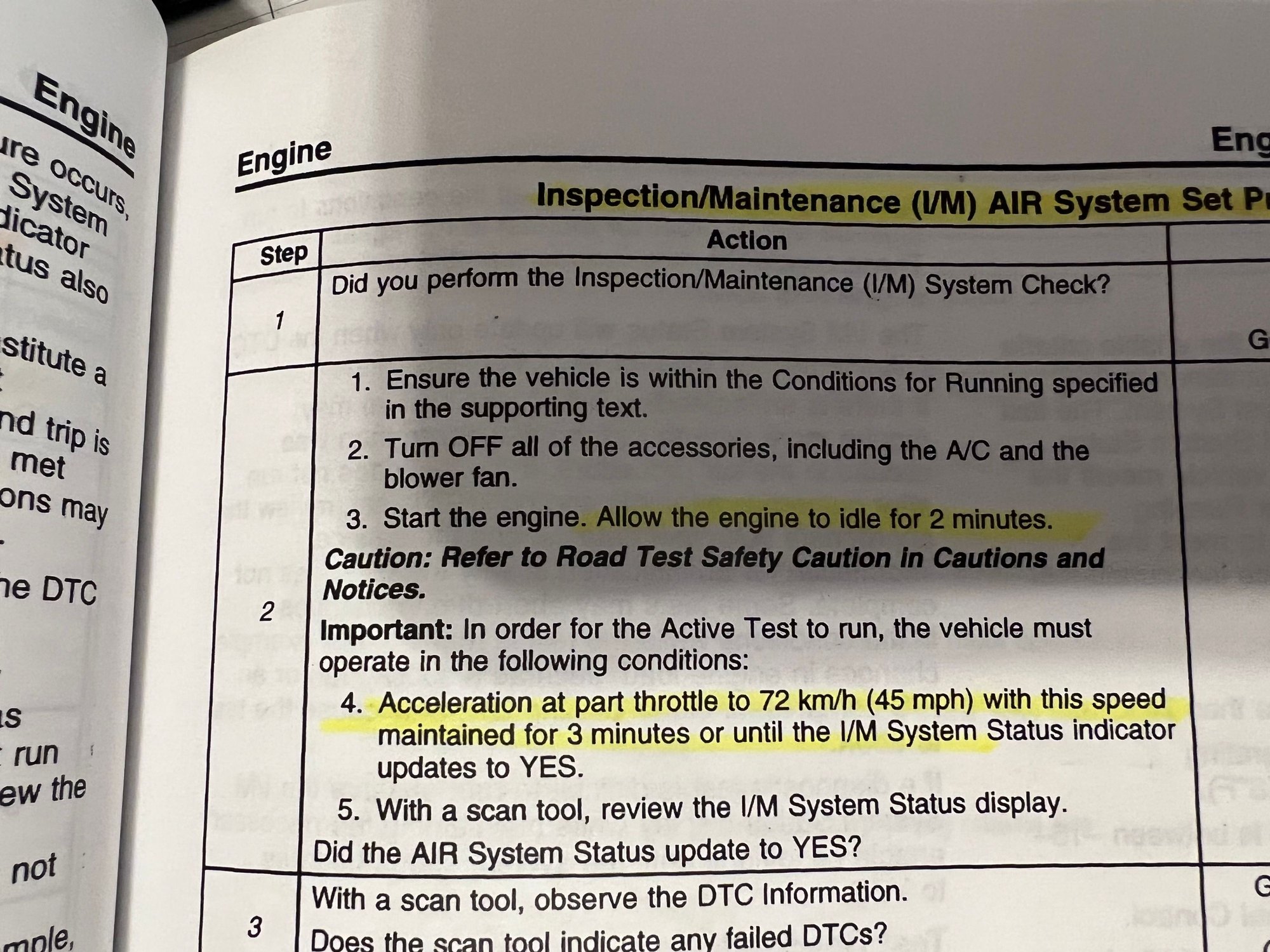

Look about 7 posts down from this one and another CA member is having issues with his catalyst monitor to complete…have any current or pending DTC’s ??…if so the monitor will not complete…he also had some AIR issues…did you follow the recommended drive cycle ??…you will need a scan tool to look at your fuel trims…if fuel trims are plus or minus 4% the test might not run…follow step 2 below explicitly!!

Look at those fuel trims if you didn’t read my edited post and follow that drive cycle outlined in step 2 !!…your work replaced all those parts for a P1416 ??…another thing is move to Florida !!…none of that emissions BS here !!

OK, just follow step 2 and see what happens…the PCM runs a “passive” test of the AIR system when the car is first started (you’ll hear the pump run)…if the passive IM test doesn’t run it will do the “active” test as outlined in the 01 FSM above at speed.

Ok so update. Went on a nice drive yesterday morning, went to go get tested again and everything went good. I passed my emissions testing after what seemed like a never ending amount of drive cycles
