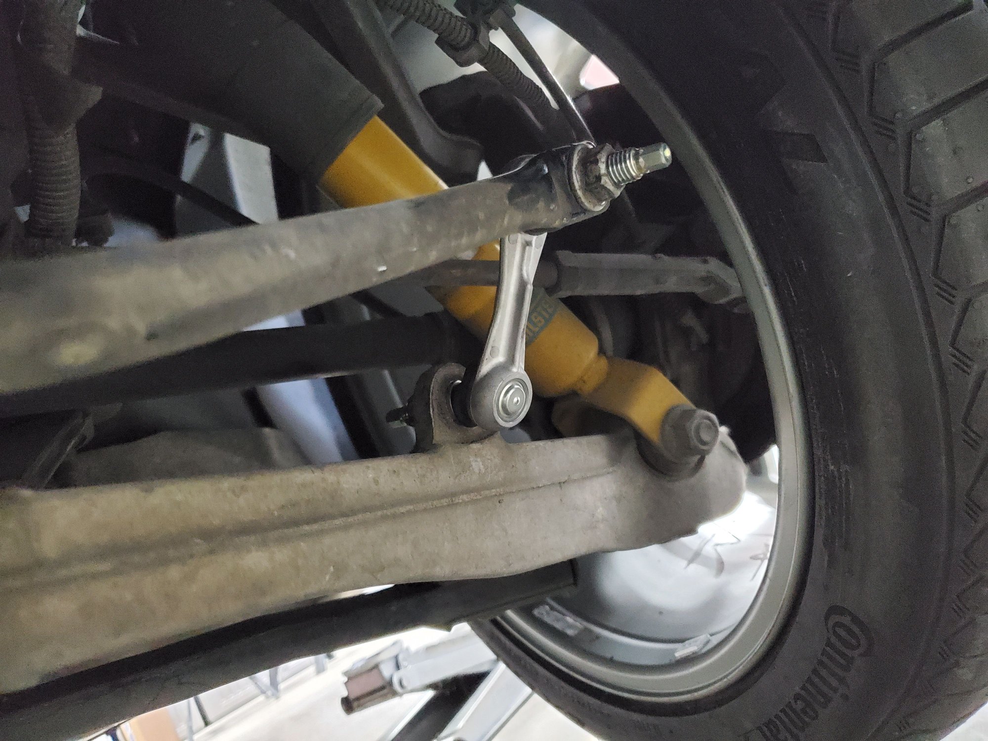

I have my black 99 in storage for the winter. She NEEDS new tires so I took the wheels off to take into Discount Tire. I've had the wheels off a couple of weeks waiting on the tires to arrive. I just happened to notice this today....
WTF? What would cause this type of failure?

It almost looks like the bar is upside down or has some issue. The links should be fairly straight inline when installed. Check and make sure. The bar pulling the links on an angle will make them fail.

The bar appears to be right-side up. If the center across the cradle from the rear is "down" and the arms are "up" then it is correct.
Those are the aluminum links. Just old and worn out. With the wheels off the car and the car presumably up on jacks the end-links and your tie rods are the first suspension pieces to resist the weight of the suspension and spring/shock pressing down in a further range of travel than when the car is on the wheels. Being pressed / deformed slightly out of their normal angles and being worn out, they simply let go.

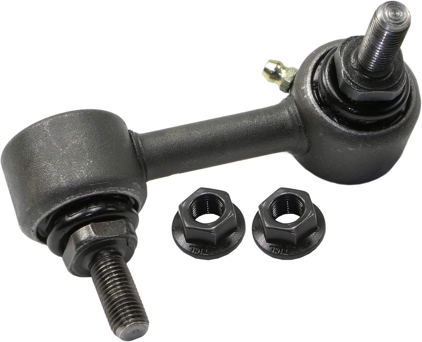

+1 for the Moog recommendation as they have zerk fittings allowing you to grease/lube seasonally
Generic non-c5 specific Moog end link image:

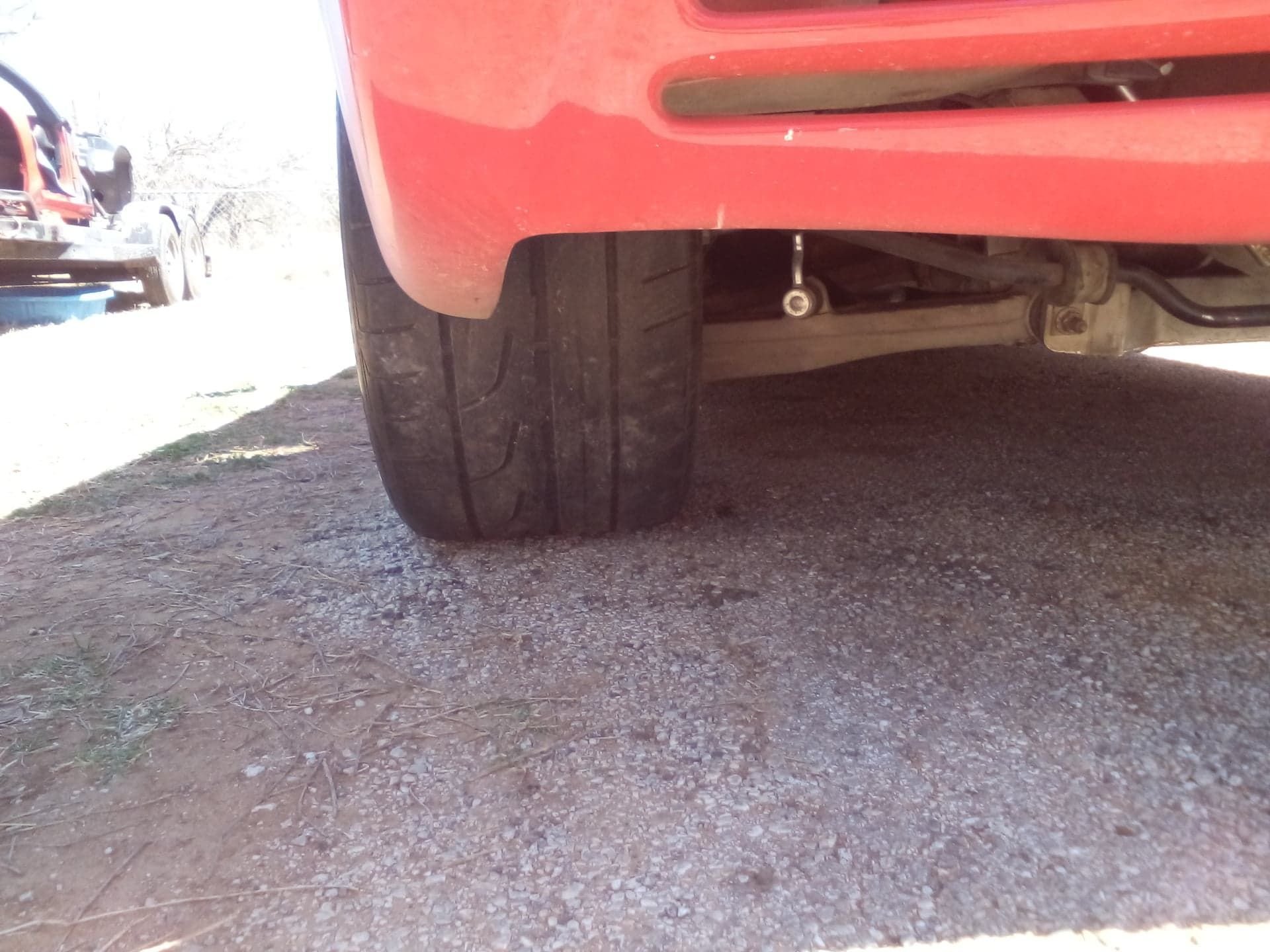

Can anyone tell what mine are stock replacements, aftermarket, later design? Mine look to have been changed in the rear. A shiny metal or aluminum. Are mine the good style not known to break like the OP's?

Five second search on RockAuto suggests yours are TRW aftermarket replacements. Better than the early gm plastic design for sure.

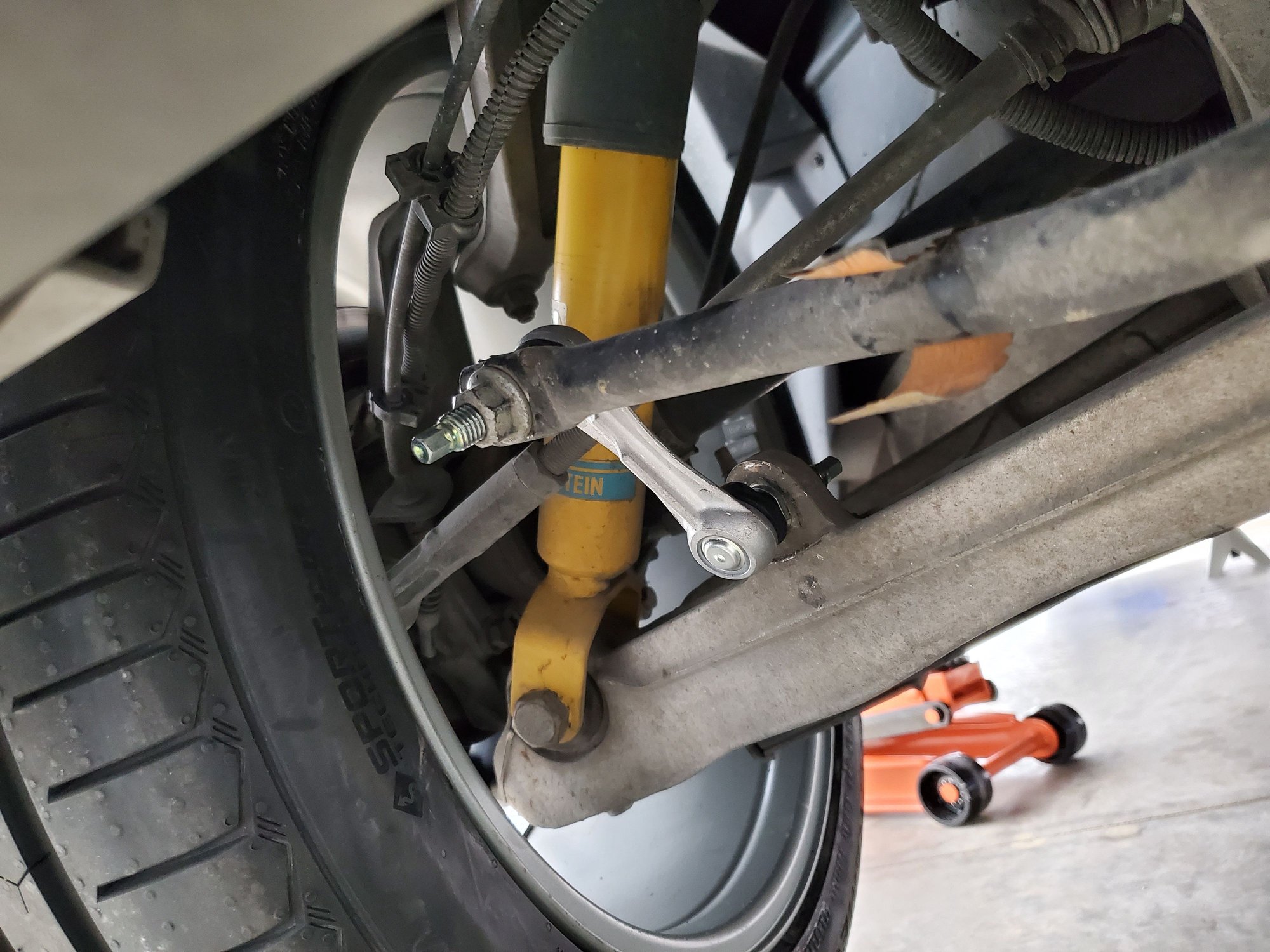

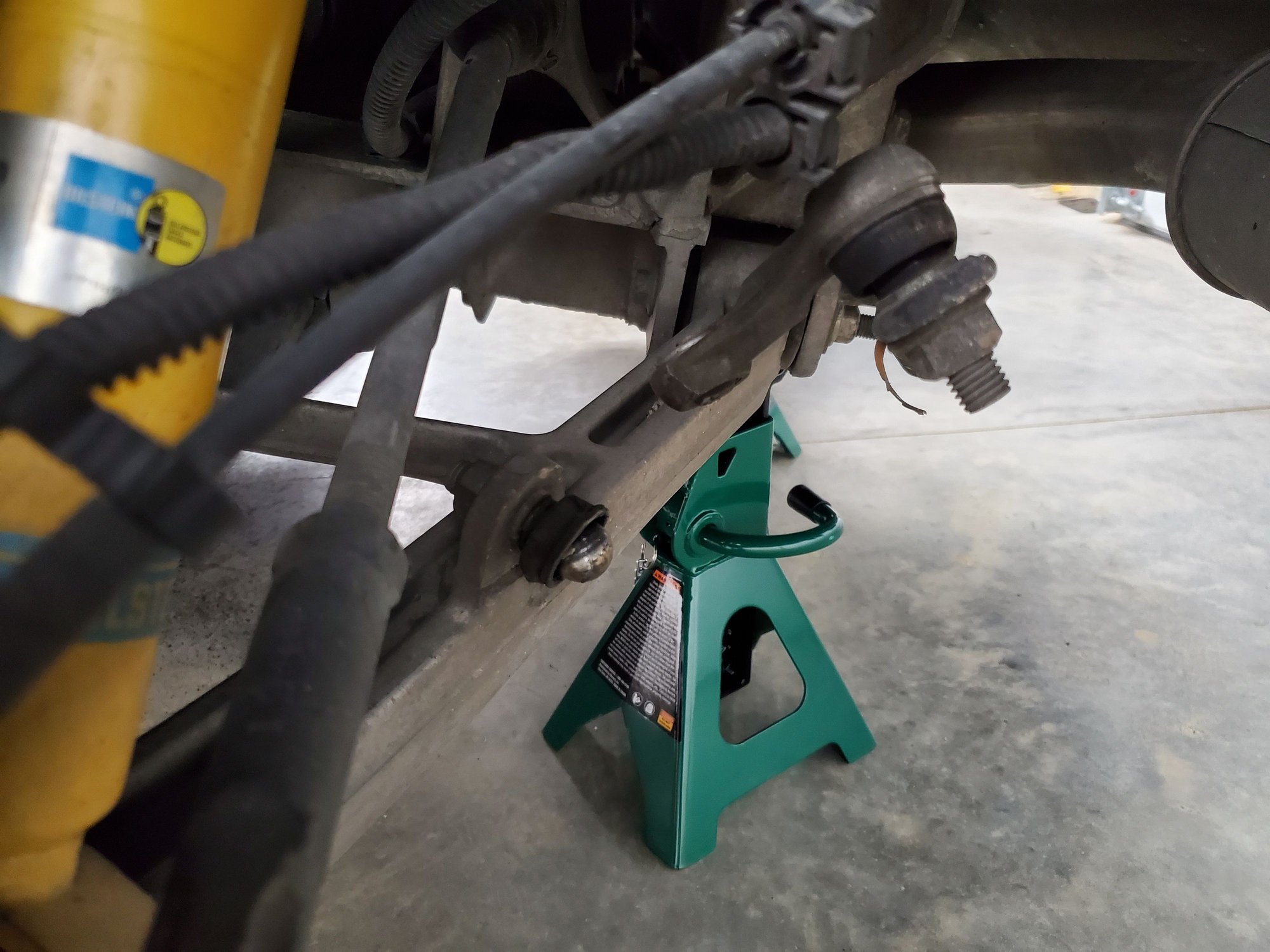

Whelp, the new ones failed just like the old ones. As I was putting on the new yet again links, I loosened the sway bar to see if I could line the bar up better but no dice.
The sway bar that is on there does have a part number on it (10283944) which comes up as a C5 rear stabilizer bar but it doesn't look like any others I have seen online with that part number. Mine has all sorts of bends in it compared to the ones online. My other two C5s don't have the stock sway bars so I can't compare but I do know this, those two C5's sway bars line up way better than the sway bar I'm working on. I think member lionelhutz has the right opinion "It almost looks like the bar is upside down or has some issue" so I'm going to take the sway bar off to see if it can somehow correct it but as of now, I don't think I can get it to line up, at least I can't imagine it doing that. If not, I'll probably cough up the $ on a used sway bar that doesn't look like this one.

The angle of the end link looks off. When the suspension is unloaded I believe it tends to angle towards the front of the car. Maybe someone backed up the car into a concrete parking stop or some other hard object and hit the bar hard enough to slightly it.

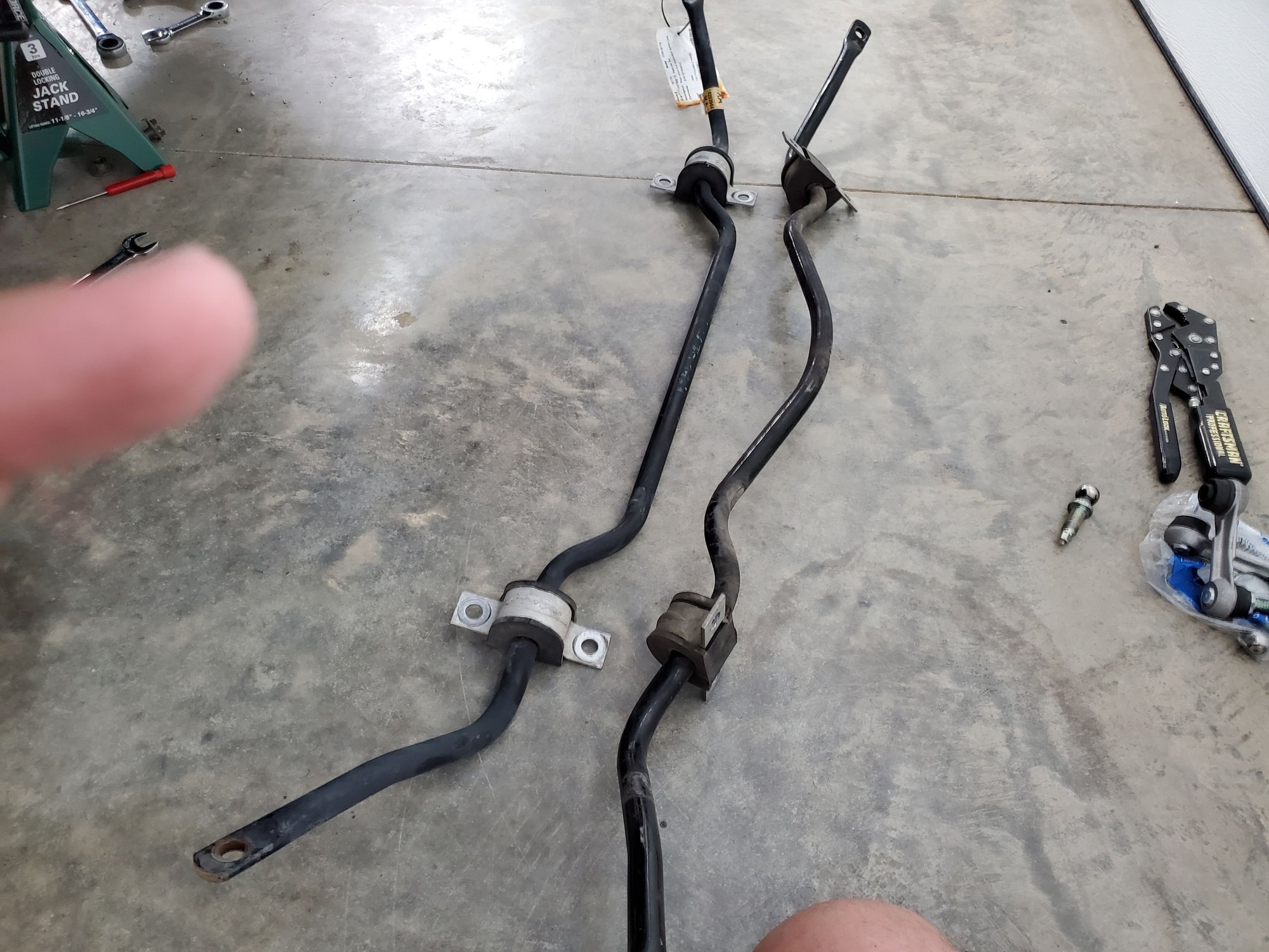

Perhaps lay the new and old bars together for a pic. Also, did you measure the diameter?
Old May 21, 2023 | 10:10 AM
knewblewkorvette's Avatar
knewblewkorvette
Joined: May 2003
Posts: 14,134
Likes: 2,979
From: Iowa
Ignore the finger and knee
The left one is the one I purchased on line and the right is the one that came off my car. I do believe the one I purchased online should work just fine. I probably should have just upgraded both front and rear sway bars
