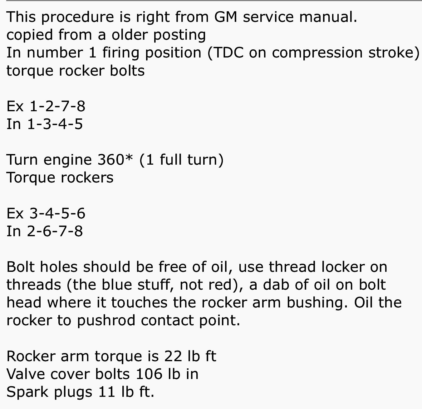

If you take the plugs out and put the trans in neutral, you may be able to turn the engine over from the alternator hub. A push button won’t get you as precise position as you will need.
Are you sure how to determine TDC compression stroke?
Here’s instructions on doing the rockers in order:

Thank you, that will save alot of time, I was under the impression I had to do each rocker individually..
