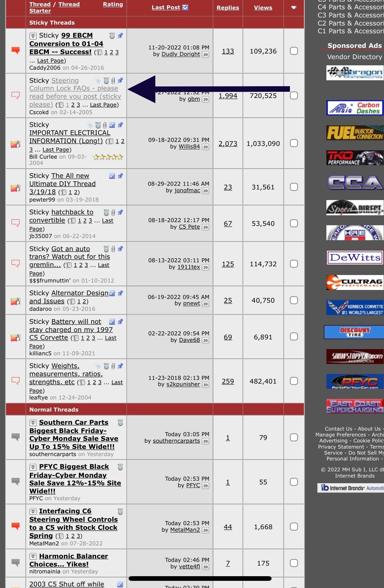

Welcome to the Forum !!...yes, I'd check for DTC's first...only emission related powertrain issues illuminate the MIL...sometimes data bus issues or low battery voltage can cause this or some other circuit issue...make sure your battery is charging properly...if your scan tool can only scan powertrain codes you may not see anything...try using the cars built in "code reader" to scan other modules…if you look at the “stickys” at the top of Tech you will see this topic covered at length.
