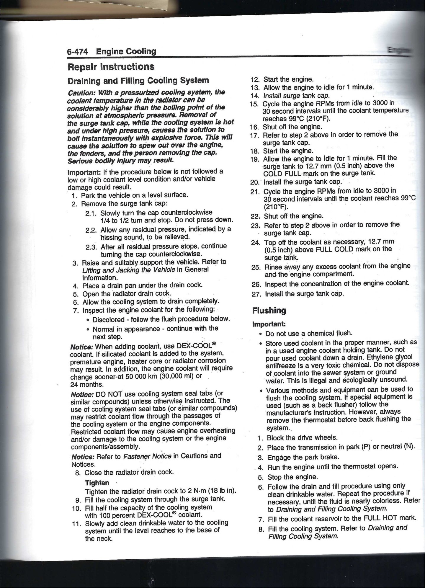

Burp the system and see where your at.

Here is the FSM procedure to remove air from the heads:
