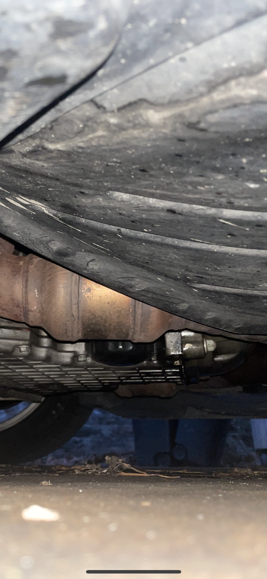

I recently started to smell An awful smell after driving for a bit, and thought it was my clutch. After inspection it appears I have a pretty good oil leak that’s getting on the exhaust, and ultimately causing the smell.
I recently had the clutch replaced in the spring and while the clutch was done I had the rear main seal replaced as preventative maintenance, so I doubt(and pray) that it’s the culprit. I have scoured some sites and one thing that keeps coming up is the oil pressure sender behind the intake. With the limited view that I had of it, it appeared to be pretty clean. What other things could be the issue here? The leak seems to be on the rear of the oil pan, as the front is clean as the picture shows. Thanks!
edit: to add, this work was done less than 2k miles ago.

Check the oil pressure sender unit, you can see it from above the rear of the left valve cover, behind the intake manifold toward the rear center of the engine. No oil should be there.

I looked there and saw no oil from what I could see. It is pretty difficult to see it well enough to rule it out though. The silver bolt(if you will) holding it in is clean. Oil pressure is reading okay also, but I know it’s probably got a gasket that may have failed. Are there any other sensors on the back of the motor that are prone to failing such as o2 or oil level sensors?

The cam position sensor is right next to the oil pressure sensor

Is it definitely engine oil, not clutch fluid?

Seems to be oil, it’s considerably darker than the clutch fluid, and my reservoir for the clutch has plenty of fluid. This seems to be coming out at a good pace too, and my clutch reservoir level hasn’t changed. I haven’t had a chance to get under the car yet to get a look at it, but I’m praying it’s something simpler than rear main since it was replaced

It could be a cracked plate the main seal is installed in.

I don't know what bolt you re looking at but the oil pressure sending unit screws into the block behind the intake manifold. It is not possible to see it with the manifold in place without an inspection mirror or fiber optic bore scope.
