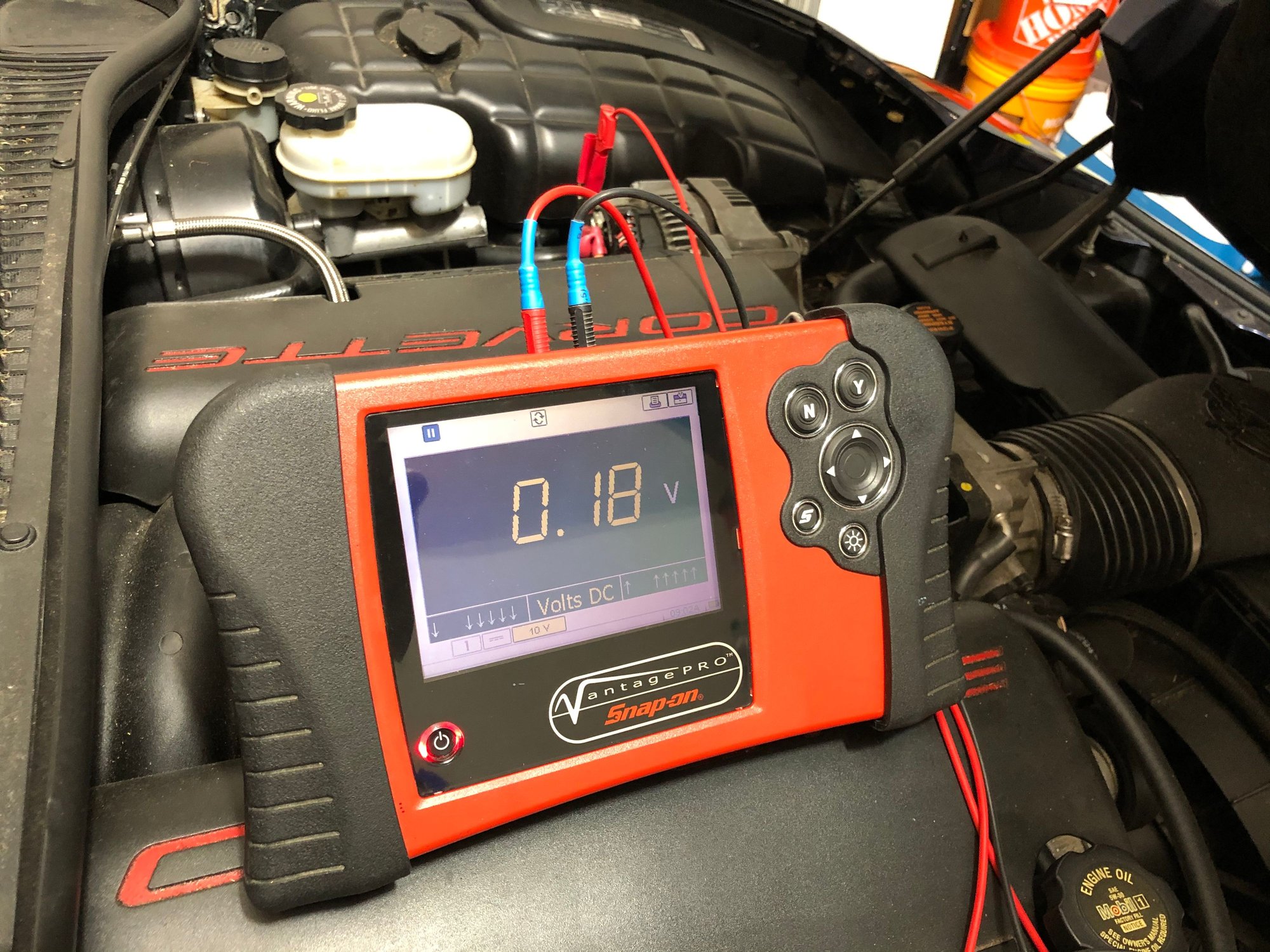

Sounds like your battery cable and also the alternator cable down at the starter solenoid may be loose or corroded down there..you’ll have to get underneath and check…try this…with the car running at 2500 RPM with an electrical load put the red lead of your DVOM on a 2 volt range and place on the positive alternator B+ post and the negative lead on the POSITIVE battery post…see what you read….to read the negative side of the charging system place red lead on negative battery post and black lead on alternator case…check your readings…should be less than .2 volts !!..column lock is due to low battery voltage so I’d have your battery checked out too !!
