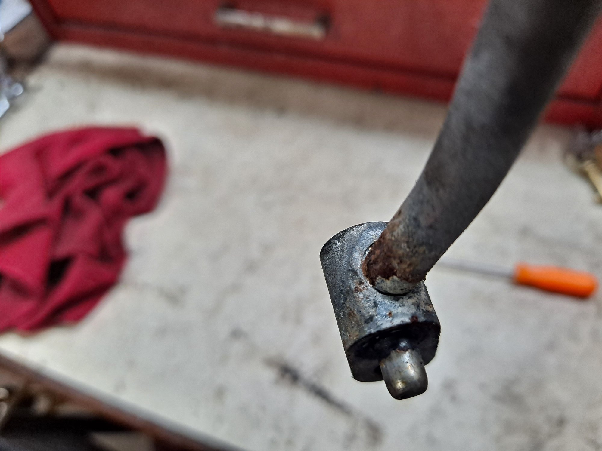

I think I know the answer however wanted the opinion of those better in the know than I. Last week I got a faint whiff of coolant after a decently long drive, just a small whiff with no sign of leakage. Today after removing the steam tubes to replace the valley pan gasket I noticed the rear passenger mount where the tube meets the mount block has some rust and discoloration around it not present on the other 3. Looks like it is leaking to me, what do ya'll think?
Yep, C5's are aging...Time to swap out that steam tube with a serviceable tube assembly. on a side note, after replacing the steam tube and before installing the intake, slave in the throttle body steam hoses and pressure check the coolant system to make sure it holds pressure and make sure there are no leaks before installing the intake.

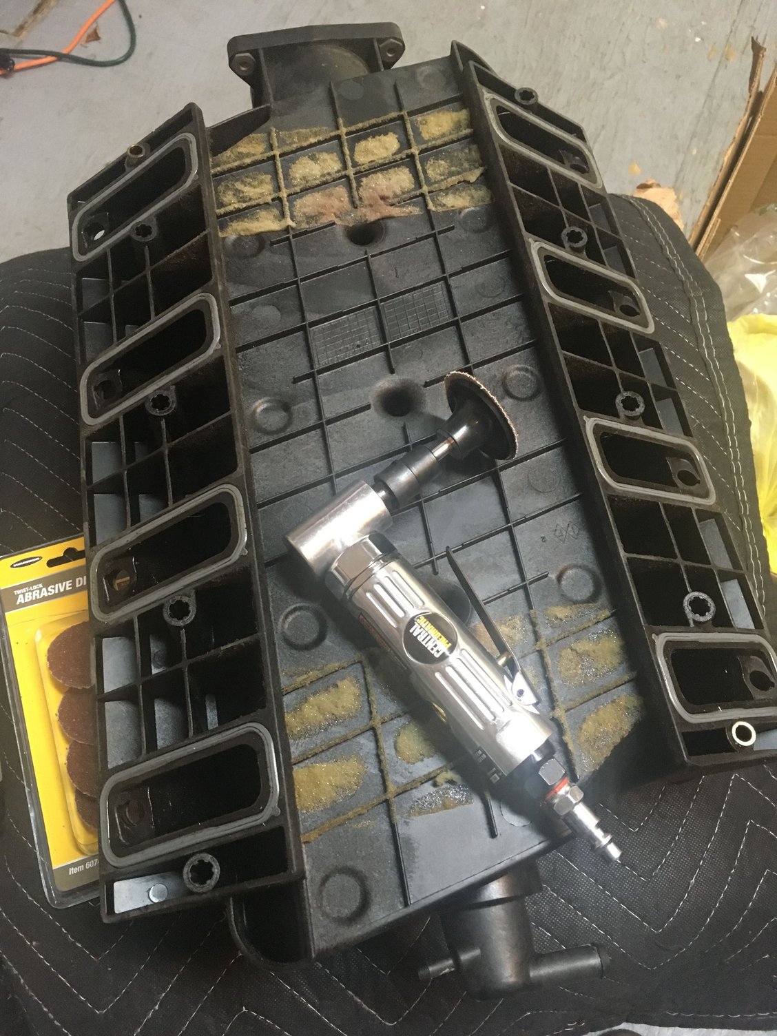

It is my understanding a LS6 intake will not fit with the LS1 crossover tubes, is this correct? I have no problem with AN fittings, I have used them extensively on my drag bikes and other vehicles. They are costly but reliable as an anvil using quality parts and proper hose assembly. I will in the future update the intake, if the stock steam lines work I will use those for sure. If not due to clearance issues I will make up AN lines now.
I removed the ribs on my LS6 and used the stock crossover, so it will work with minor alteration

From: South Florida
There is some talk of the LS6 intake exploding under boost pressure without those reinforcement, that people removed for the crossover.
It is the main reason I stay with LS1 intake on turbo engine, the 4-port OEM steam crossover is worth the downgrade to maintain simplicity.

There was a discussion on this forum a long time ago about the ribs on the underside of the intake, and some people "in the know" about the production of these intakes said the ribs where for assembly line reasons only and had absolutely no structure bearing on the intake itself.
This is why I did it.
