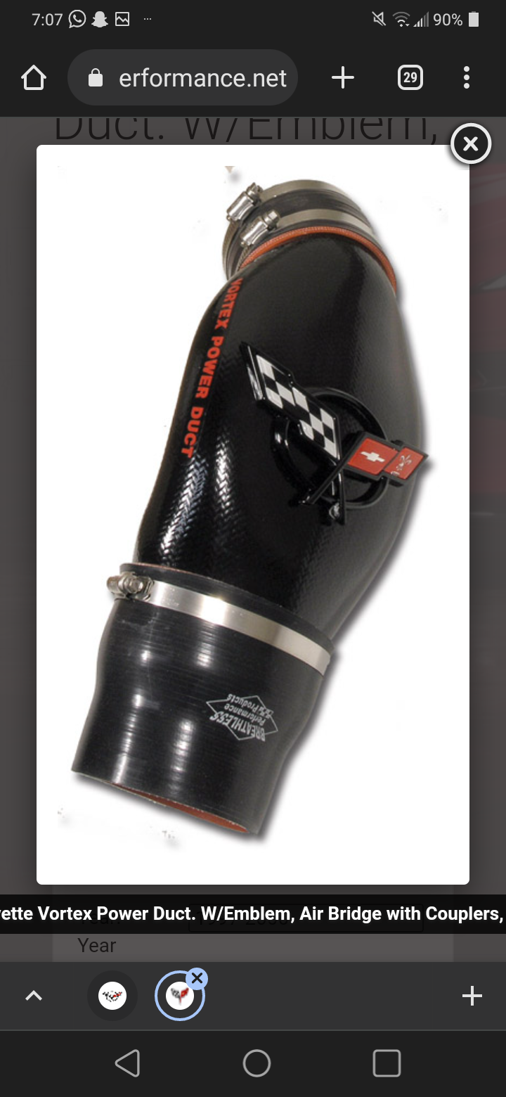

Quote:
You are correct sir! The Vortex airbridge is not the same as the Vararam air bridge. And now it's on a shelf in the garage next to the Vararam and the Blackwing. Originally Posted by grinder11
I think Johnny has a non-Vara-ram airbridge. So the Vara-ram bridge may actually fit better, but I guarantee nothing!!

Quote:
Hey, Johnny-Were you able to get the airbridge w/o buying the entire Vortex Rammer setup? I tried a few years ago to get the Haltech Stinger airbridge, and they wouldn't sell it separately. Told me I'd have to buy the entire setup!!Originally Posted by Johnny Hardcore

Quote:
Indeed I was. It was much cheaper 20 yrs ago but it's still obtainable as a single part with couplers. Asthetically the best looking C5 performance air bridge available in my opinion.Originally Posted by grinder11
https://www.c6performance.net/catalo...s-p-42674.html

Quote:
I think I paid a little over $200 for it. But can't recall exactly. Definitely not over $300. Originally Posted by vette4fl
Expensive, but a nice looking piece of engine bling!
The duct is gerthy, made of Fiberglass and well constructed. Night and day compared to crap plastic offered by most vendors.
I'm seeing Zip has them for $299 (aka-about $320 with tax!!). Do you think this flows better than the Vara Ram duct?Originally Posted by Johnny Hardcore
I think I paid a little over $200 for it. But can't recall exactly. Definitely not over $300.The duct is gerthy, made of Fiberglass and well constructed. Night and day compared to crap plastic offered by most vendors.

Quote:
I doubt there is much difference in flow rate between the two on a performance build. No impact at all on stock.Originally Posted by grinder11
Construction quality and visually wise though there is zero comparison between them. The Vortex being of MUCH better quality.
